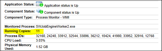

This is a workaround which will address inability to natively set a threshold for the Process Monitor Component to effectively Alert on Running Copies. Well, you "kind of" can do it now already, as described here Re: Running Copies - Trigger alert when number of running copies is greater than 1 but this will not work for different components with different threshold requirements. You will most likely end up with multiple alerts for every case... with mess other words

SO, HERE IS WORKAROUND:
LET'S SETUP ALERT FIRST
(1)

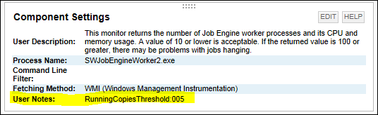

SETTING UP THRESHOLDS
From now on, all you need to do is the following:
In order to set a threshold you can do this per component. Simply add the following string to the beginning of the User Notes
