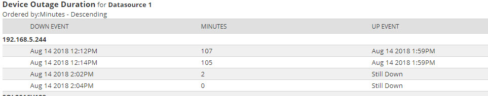

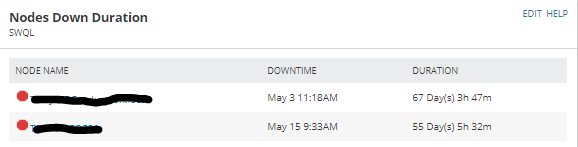

I had assembled this based on a much older SQL report, and then updated it to SWQL, then added some more intelligence to it so you can filter it based on the duration of the outage, search by the device names, and it has a method of letting you know when nodes have been down so long they aged out of the events table.
Based on popular requests I figured it was time to put it out here to make it easier for the Thwackers to find and use. This is intended to be used inside the Custom Query Resource

-- figures out the minutes between the down and up events, if the object is still down it counts from the down event to now, displays 99999 if we cannot accurately determine the original downtime, and
, isnull(MINUTEDIFF(t2.[Down Event], isnull(t2.[Up Event],GETDATE())),99999) as Minutes
