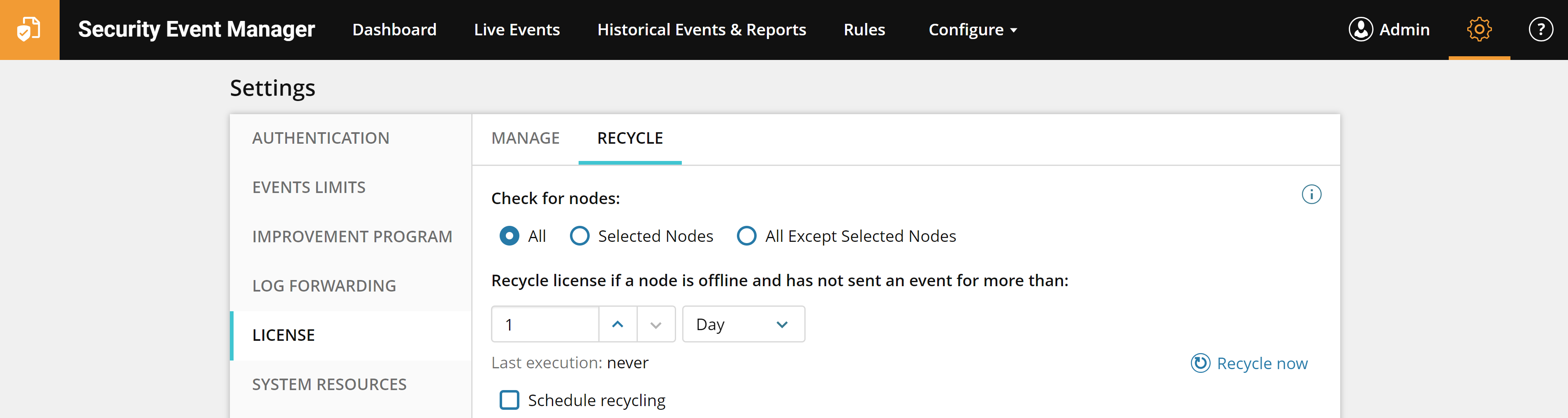

The target nodes are a set of nodes configured in the license recycling configuration. The following options are available to define this set:
All – All nodes are a target.
Selected nodes – Only nodes that belong to one of the selected user-defined groups or have one of the selected connector profiles configured are a target.
All Except Selected Nodes – All nodes except for nodes that belong to one of the selected user-defined groups or have one of the selected connector profiles configured are a target.
The following example shows a license recycling configuration located in the SEM user interface at Settings > License > Recycle.

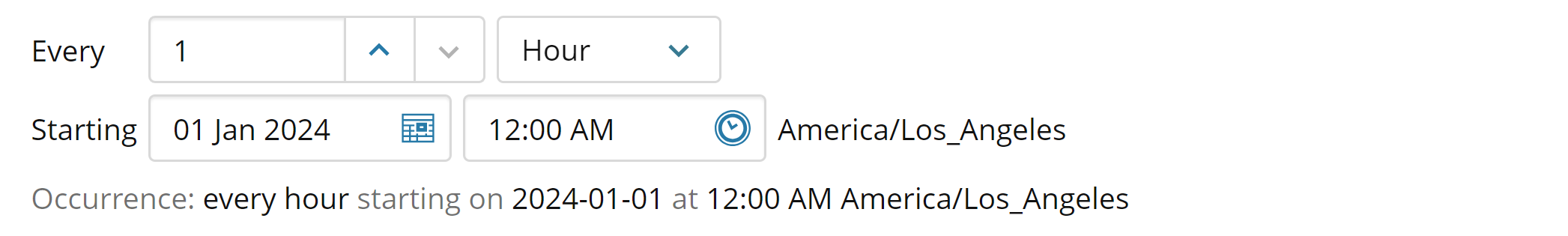

License recycling executions can be scheduled with intervals in minutes, hours, days, weeks, and months. The interval length can be customized from 1 to 2,147,483,647 units. Each interval option includes a starting time.
Starting time
The starting time is the point in time used to determine the time of the first execution. If the starting time is set in the past, license recycling calculates the schedule from that point in time (not the present time). Instances calculated in the past are not considered for execution.
For example, with an interval of "every 10 minutes," a starting time set to today at 10:30 and the time on the SEM machine at the moment the configuration is saved is equal to 10:30.17, the first execution will occur at 10:40.00. It works analogously for an hour time interval.
For day, week, and month intervals, the scheduling behavior is different. The first execution occurs at the first configured time occurrence (and possibly day) after the starting time. The starting time is 00:00 (12 AM) of the configured starting day.

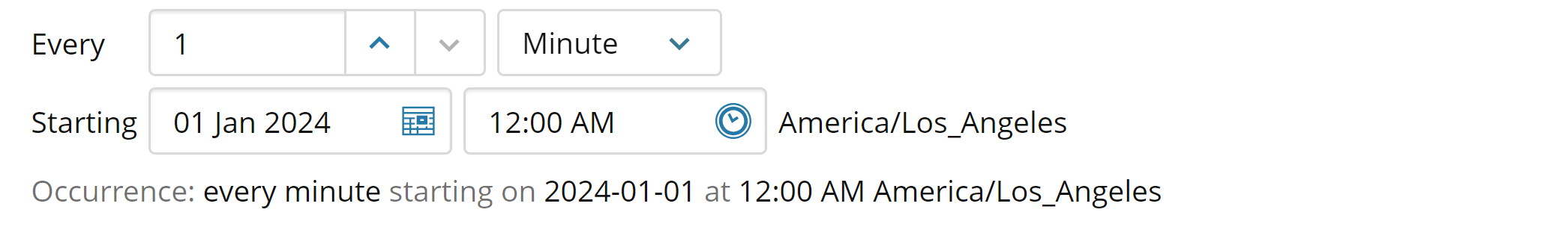

Minute interval
When the minute interval is selected, license recycling is executed every nth minute starting precisely at the whole minute that is set in the configuration.
Hour interval
When the hour interval is selected, license recycling is executed every nth minute starting precisely at the whole hour that is set in the configuration.

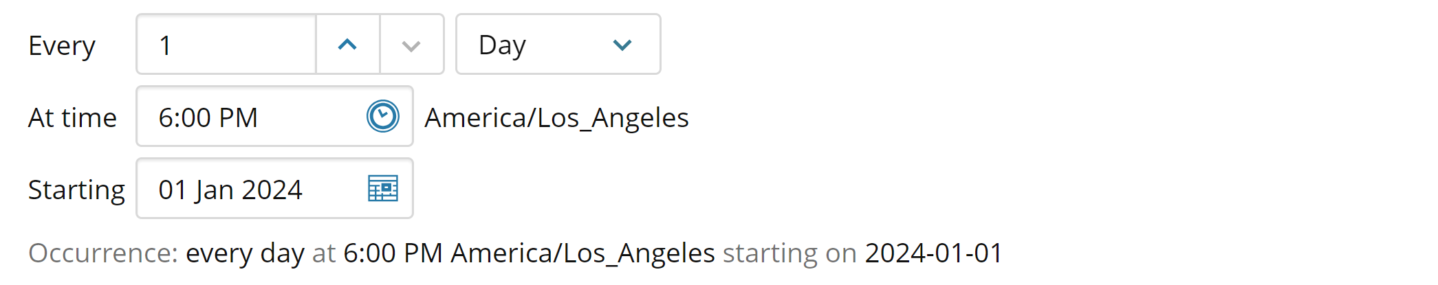

Day interval
When the day interval is selected, license recycling is executed every nth calendar day at the selected time.

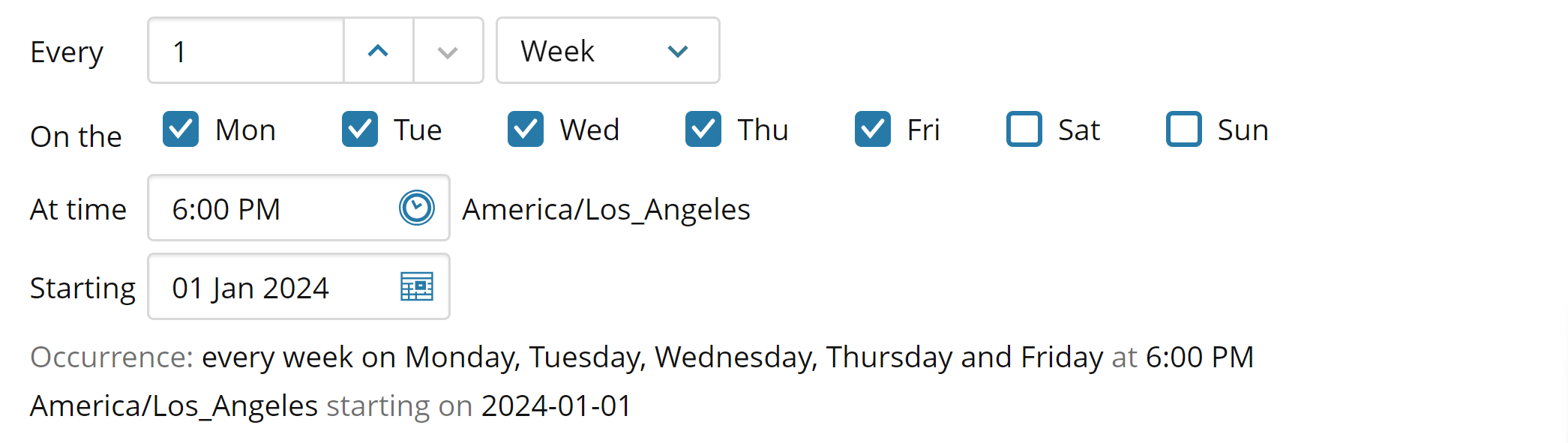

Week interval
When the week interval is selected, license recycling is executed every nth calendar week on the selected days of the week and at the chosen time.
The first occurrence for each day of the week is calculated separately.
For example, if the selected interval is “every 2 weeks”, Tuesday and Thursday are selected, and the starting time is the upcoming Monday, license recycling will first execute on Tuesday and Thursday following the upcoming Monday, and then every other week on Tuesdays and Thursdays.
If the starting time was the upcoming Wednesday instead, license recycling would first execute on Thursday following the upcoming Wednesday, then on Tuesday the following week, and on Thursday the week after that, continuing in this pattern.

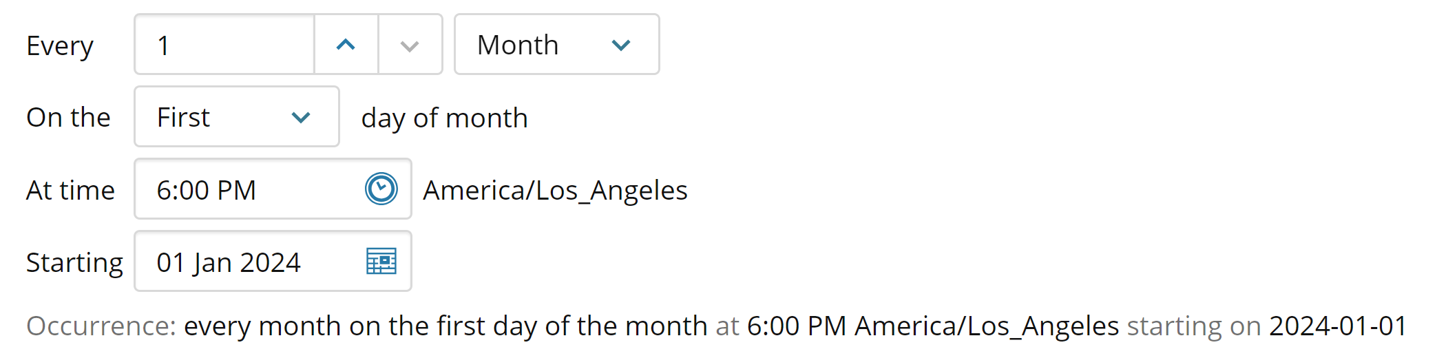

Month interval
When the month interval is selected, license recycling executes every nth calendar month at the selected time on the 1st, 15th, or last day of the month.

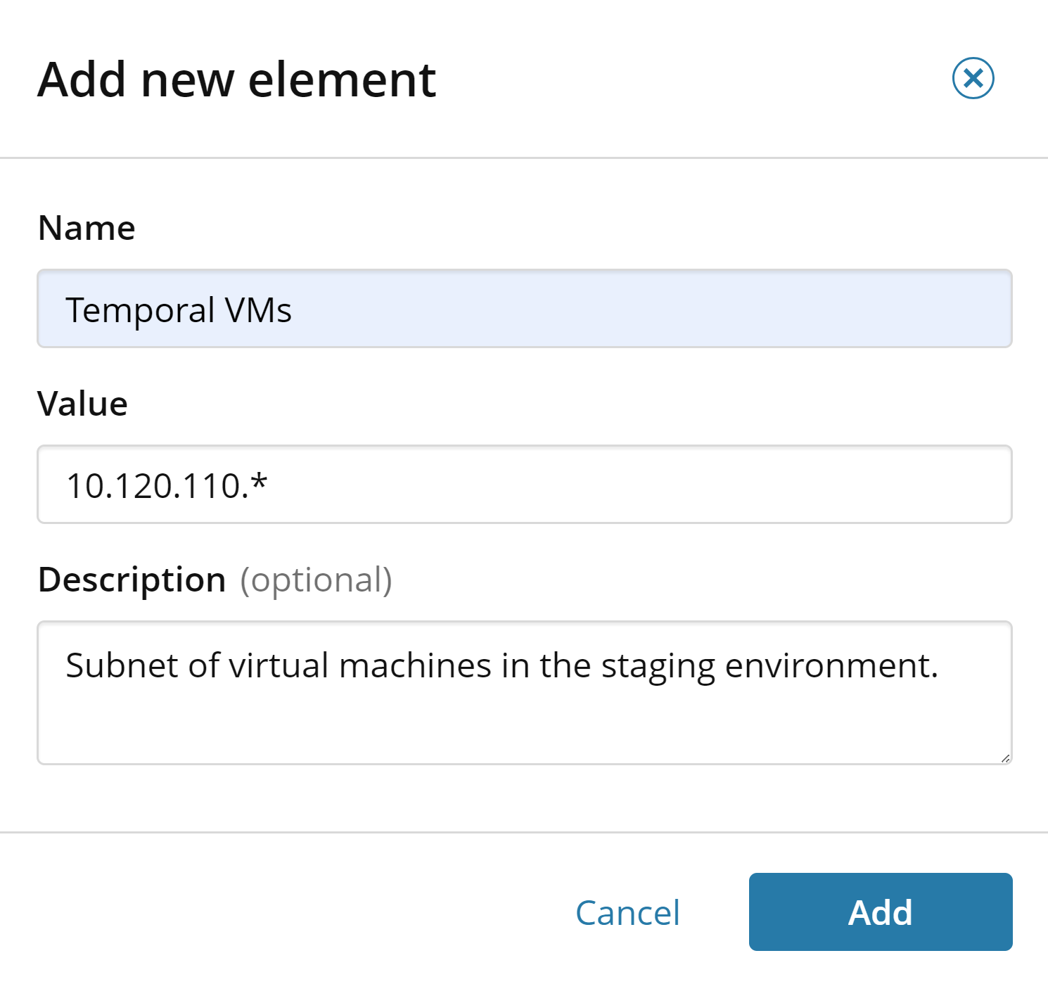

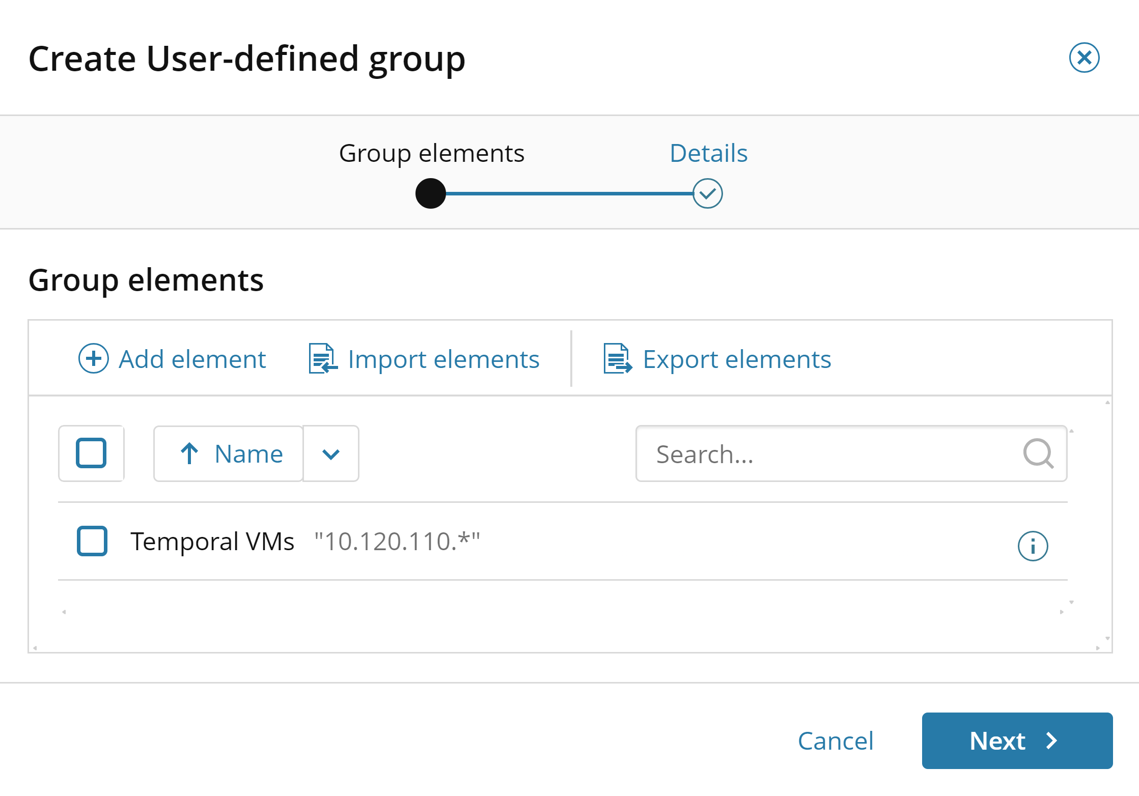

Let’s consider a subnet of monitored virtual machines (10.120.110.0/24) with preinstalled SEM agents. These machines are deployed and used for varying durations, ranging from 1 day to 3 months. Once these machines are no longer needed, they are powered off and removed. On average, 5 machines are added and removed each workday.
Additionally, we have approximately 1,000 employees, each equipped with a Windows laptop or desktop machine connected across multiple networks. Each of these machines is running a SEM agent with a configured connector profile named “Employee nodes”. On average, 12 employees leave the organization each month.

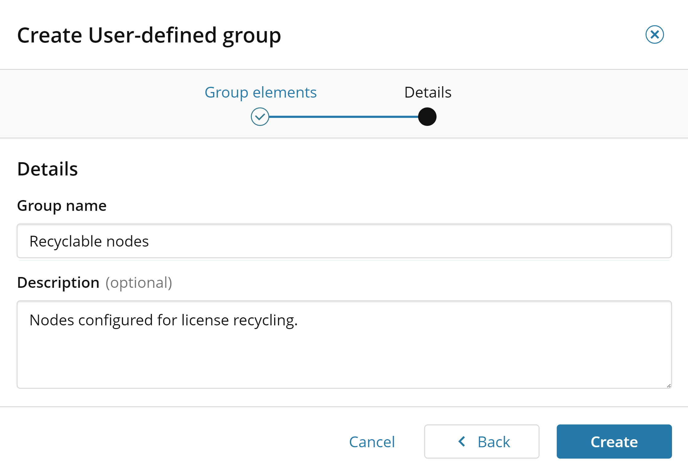

To assign all virtual machines to license recycling targets, we can create a user-defined group and configure it accordingly, as shown below.
Next, we can open the license recycling configuration at Settings > License > Recycle, select “Selected Nodes”, and then select the new user-defined group and corresponding connector profile. We will choose an inactivity time of 1 month. Selecting a shorter period could result in removing the employee nodes during a longer period of employee inactivity (for example, when the employee is on vacation and their device is shutdown). License recycling will be scheduled once a week on Fridays after work hours. More frequent license recycling executions would be useful when a larger number of nodes become inactive each month—for example, in case of higher fluctuation of virtual machines in the environment.
