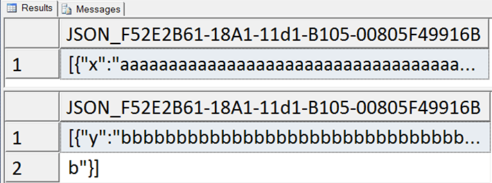

There are some quirks involving string lengths - it seems that if your JSON string (including delimiters) is longer than 2033 characters, it will get spread over multiple rows in the output.
DECLARE @t TABLE(x NVARCHAR(4000));
INSERT @t(x) SELECT REPLICATE(N'a',2023);
SELECT x FROM @t FOR JSON PATH;
DECLARE @u TABLE(y NVARCHAR(4000));
INSERT @u(y) SELECT REPLICATE(N'b',2027);
SELECT y FROM @u FOR JSON PATH;
Results:
I'm not sure if that's a symptom of very early builds or how it is intended to work; if the latter, your consuming applications will need to account for the way the data is returned.
