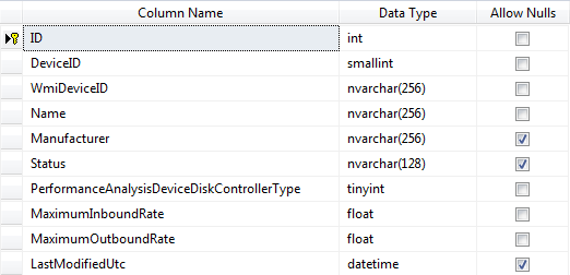

Controller
The disk controller table lists out all the disk controllers discovered via WMI and/or VDS queries. There are a few bits of information that may be useful, like the manufacturer and inbound and outbound maximum rates, but remember to take these values for what they are, which is what is reported back from the WMI repository from their providers. The accuracy of the information is tied to how much care and feeding those WMI providers were given by the manufacturer.
PerformanceAnalysisDeviceDiskController
Note the foreign key back to the controller type table. This is important for our queries, so that we can narrow down the working set by entire types of controllers.

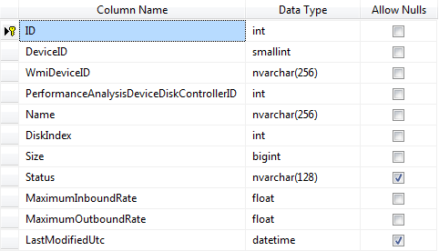

Disk Drive
The disk drive table represents the "physical" disk. We shouldn't take the term "physical" literally, as we're really just talking about a unit of space carved out for the server to use. It could be a physical disk, but it could also be a VHD, Mount Point, LUN carved out from a SAN or whatever else you can think of.
PerformanceAnalysisDeviceDiskDrive
We're finally starting to get a familiar piece of data, as this is where we can see the size of the disk. This one isn't necessarily the one we want to use for a query, for reason that we'll see in a bit, but it's still important to know the actual capacity of the disk itself.
We can't quite use the name yet, as by querying the table, you'll see the name is basically the DeviceID from WMI:
| Name |
| \\.\PHYSICALDRIVE0 |
| \\.\PHYSICALDRIVE1 |
We're getting closer though!

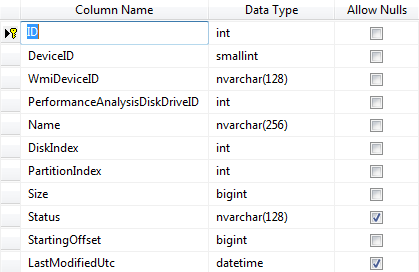

Partition
Whenever we get a nice chunk of space, we can carve it up into partitions, right? This table lists those partitions, simple as that.
PerformanceAnalysisDeviceDiskPartition
Again, here size is somewhat useful, but the name isn't good for reporting out just yet.
| Name |
| Disk #0, Partition #0 |
| Disk #0, Partition #1 |
| Disk #1, Partition #0 |
We store these items, as they are used internally for displaying the various screens in SQL Sentry, but we probably won't see the "name" most folks are familiar with until the next table.

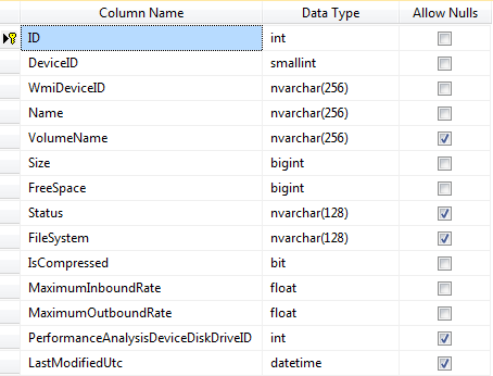

Logical Disk
At last, the part we've been waiting for. The location of the volume names we're familiar with along with their size, free space, status and a few other goodies.
PerformanceAnalysisDeviceLogicalDisk
After everything else, this is where I'm trying to get to so that I can build a simple query that reports on low free space globally by server.
There is one issue though. This maps back to disk, but not to partition. If I want to include partition data with this, then I need some sort of mapping.
Why is this? Think for a moment, and you probably already know the answer. We can have volumes that span multiple partitions. That's why partition to logical disk needs a mapping table.
Luckily, the last table we're going to look at today, does just that.

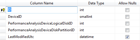

Logical Disk to Partition Mapping
As I stated above, logical disks can span multiple partitions, so we need a mapping table for this in order to be able to create an accurate picture of the disk system.
Once in a blue moon, we'll find that the system is reporting incorrect information from WMI about what logical disks map to what partitions, and this mapping table will be missing some rows. If that happens, you'll not be able to see these logical disks in the Disk Activity or Disk Space views of Performance Advisor. As such, this is one of the tables our support engineers look to if someone reports that something is missing in one of those views.
In addition, letter drives (C:, E:, Z:) will have a NULL PerformanceAnalysisDeviceDiskDriveID in the PerformanceAnalysisDeviceLogicalDisk table. This is because they map to partitions directly. Mount points have a value for PerformanceAnalysisDeviceDiskDriveID so we can easily tell what drive they are mounted on. Because of this, we need to join to this mapping table to make sure we're getting all of our logical disks in a query.
PerformanceAnalysisDeviceLogicalDiskToPartition
Note that this is a standard "many to many" mapping type table with its own surrogate key, and foreign keys back to the logical disk and partition tables.

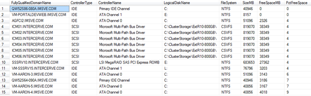

On a test server at SQL Sentry HQ, I can see results like this:
Sample results from a test server
Looks like the QA team is chewing through storage like Pac-Man at a lemon drop factory! For shame…
