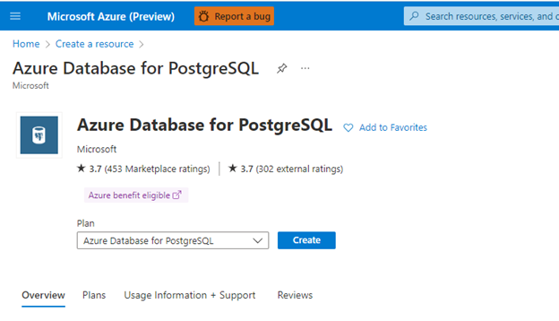

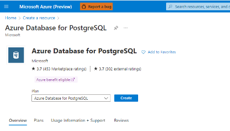

Let’s create an Azure Database for PostgreSQL Flexible Server via the Azure portal. Once at the portal, I click on the “Create a resource” option, search for “Azure Database for PostgreSQL,” and click the “Create” button.

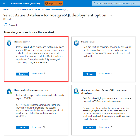

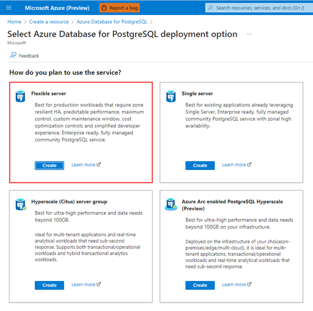

The next page is where I’ll choose a deployment option. I’m looking at Azure Database for PostgreSQL Flexible Server, so I’ll click the “Create” button on the “Flexible server” option.

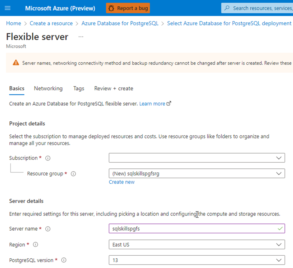

Next, I’ll need to enter some information to configure my PostgreSQL server. I’ll first need to create a resource group inside of my Azure subscription. A resource group is a logical container in Azure where resources are contained. I’ll also need to give this PostgreSQL server a name, a region for where the server will be located, and the version of PostgreSQL I want installed on this server.

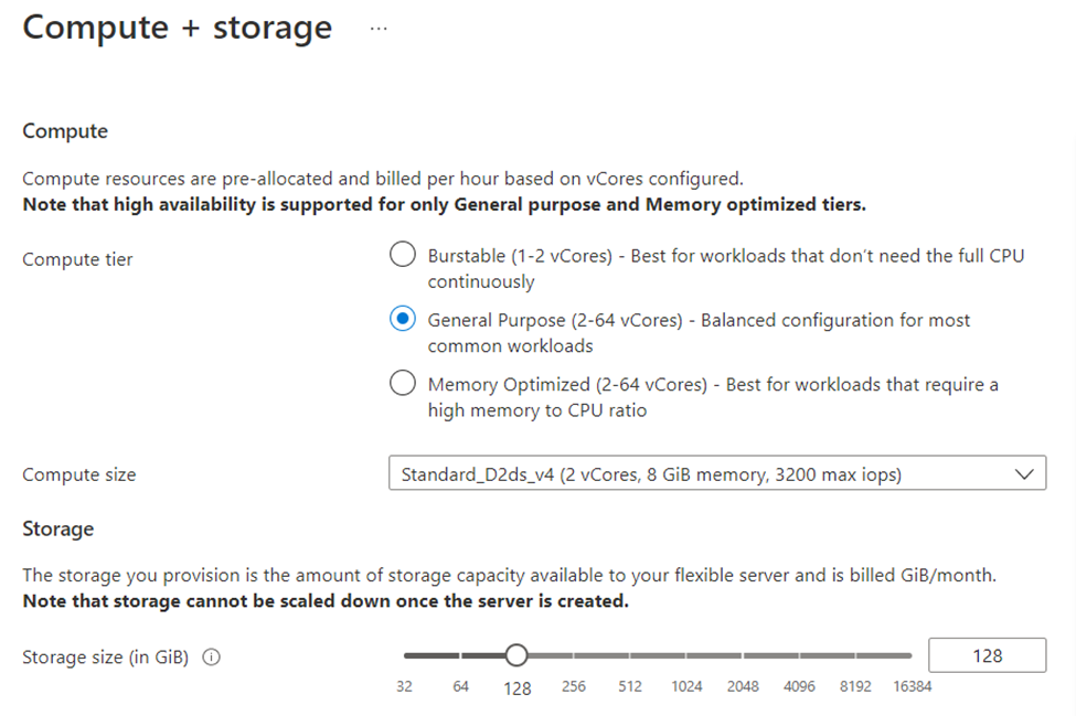

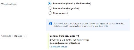

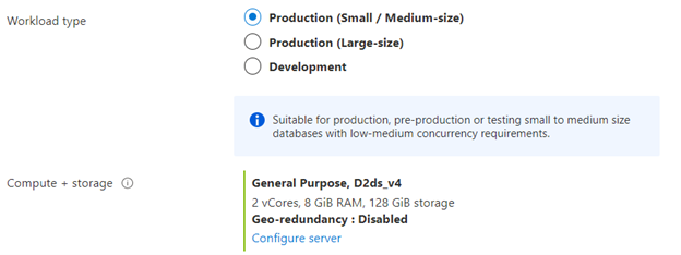

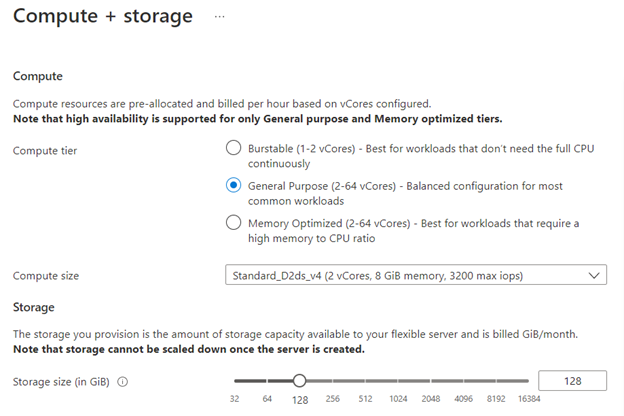

I’ll need to assign resources to this server based on my expected overall throughput. Here, I’ll choose the small/medium-sized prodution tier as the workload type. Under “Compute + storage,” I’ll click “Configure Server” so I can assign the necessary number of virutal cores, memory, and storage.
The tiers are differentiated by the amount of compute in vCores capable of being provisioned, memory per vCore, the storage technology used to store the data, and—of course—pricing. The first choice I’ll need to make when configuring compute and storage is which compute tier to use. The burstable tier is great for applications not constantly needing CPU. These are generally smaller applications or those only needed for certain times throughout the day. The general-purpose tier is applicable to most workloads needing dedicated CPU throughout the day and balanced compute and memory with scalable IO throughput. The memory optimized tier is for high-performance applications reuqiring a lot of memory, fast disks, and high concurrency needs, and high-end transaction processing production applications should be assigned to this tier.

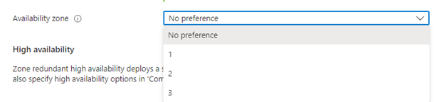

As I mentioned before, one great feature of Azure Database for PostgreSQL Flexible Server is the ability to co-locate your applications and your PostgreSQL database. The way this is done is via availability zone placement. An availability zone is a physical location within an Azure region, which you can think of logically as a specific Azure data center. When your database and application are in the same physical Azure location, you can take advantage of the proximity between the two to minimize latency.

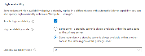

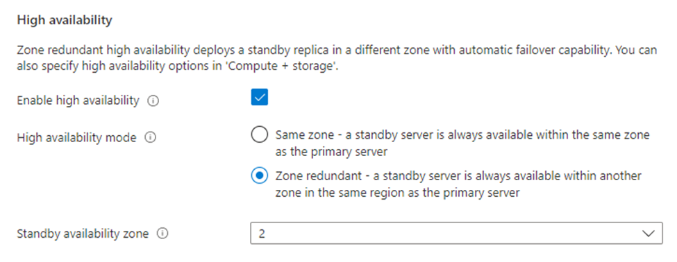

When high availability is configured, Flexible Server automatically provisions and manages a standby replica. “Same zone” places the primary and the standby server in the same availability zone. This option has low network latency and a service-level agreement (SLA) uptime of 99.95%. There’s no need to configure application redundancy with this option, as the application, primary, and standby server are all in the same Azure availability zone.
The “Zone redundant” option provides redundancy across availability zones within an Azure region. This option requires a bit more configuration, as you’ll need to make sure your application is also redundant across zones to ensure it’s highly available. This option gives you a guaranteed uptime of 99.99% vs. the 99.95% option the “Same zone” configuration gives you.

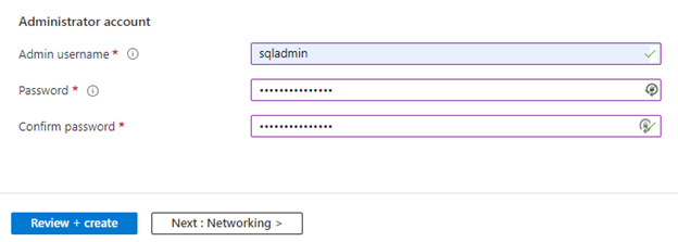

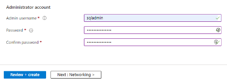

The last information I’ll need to enter on the initial configuration page is the admin username and password. Make sure to keep track of this information—you’ll need it later when logging in to the server.

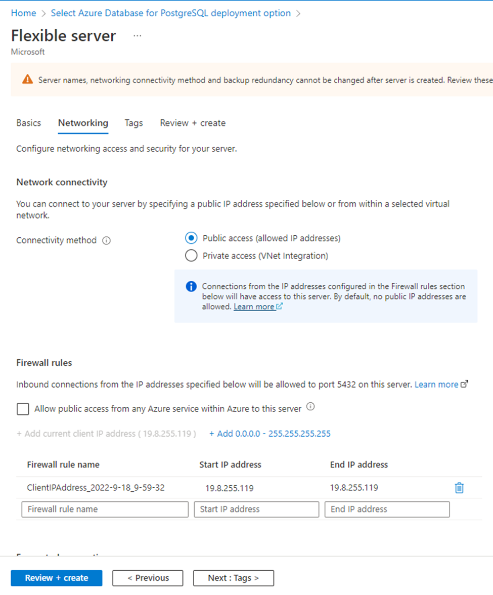

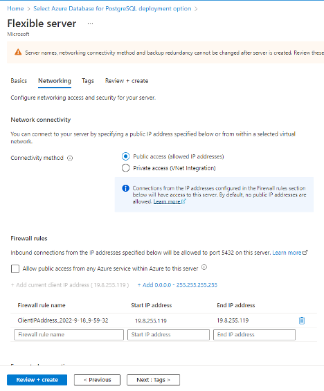

Finally, I’ll need to choose how connections are going to be made to my Azure Database for PostgreSQL Flexible Server. If I’m going to have applications running from VMs or the Azure App Service, I can limit any public connections to my database. However, if applications or users from the public internet need to connect to my database, I’ll need to choose the “Public access” option. Here, I’m going to choose the public option and enter my public IP address into the firewall rules.

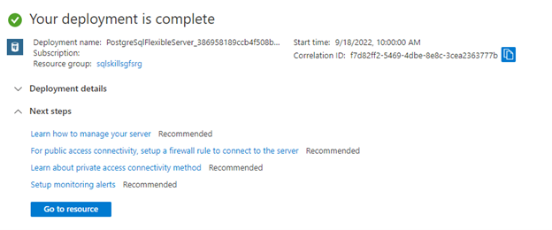

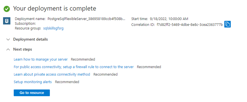

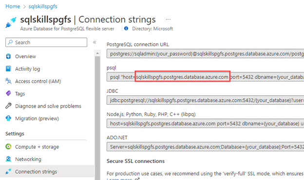

Once the deployment is complete, I should be able to connect to my new PostgreSQL database. To connect to the database, I’ll need the server’s full name. I can navigate to the “Connection Strings” blade in the Azure portal and grab the server name from there.

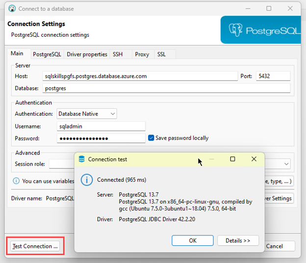

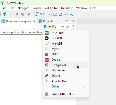

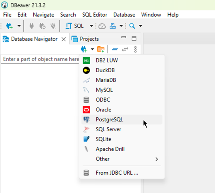

For integrated development environments (IDEs) for OSS systems, I really like using DBeaver. It’s easy to arrange scripts into projects, it’s relatively lightweight, and its Community Edition is free to use. I highly recommend testing it out if you find yourself administering various relational database platforms on a regular basis.
Let’s open DBeaver and add a new connection to PostgreSQL.
Under the connection settings, paste in the full name of the Azure PostgreSQL server you copied from the Connection Strings from the Azure Portal in the previous step. Then, enter your admin username and password. Once you’ve entered everything correctly, you should click the “Test Connection” button to ensure you can connect to your new PostgreSQL server.
