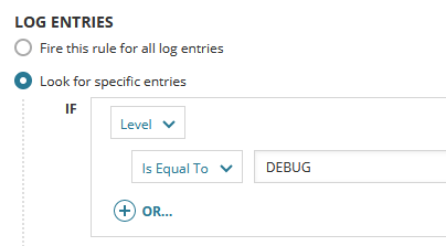

Dropping Surplus Events
Many devices are sending events with low information value that don’t need to be persisted (DEBUG-level syslog messages, for example). Such events can be discarded simply by configuring processing rules. Dropping these surplus events should allow for higher ingestion rates as long as the number of stored events in the database will still be at the 1,000 EPS level. For example, if there are 10 devices each sending 200 EPS and we drop 50% of the incoming messages without storing them, then we’re still within the recommended limits. This is true even though there are overall 2,000 EPS sent to Log Analyzer. This is because the processing pipelines can process up to 3,000 EPS, with short bursts of up to 5,000 EPS.
To create such a rule, first we configure the condition specifying which events should be discarded.

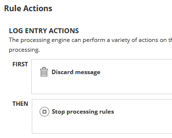

The next step is to configure two log entry actions:
The first action will cause the message to be discarded instead of stored. The second will ensure we stop processing any other rules for this specific message—this will cause the message to be discarded immediately.
