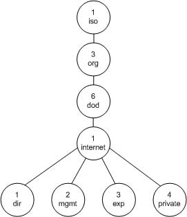

This diagram shows the structure of MIBs from the root to these branches.
