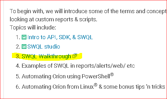

Topics will include:
- Intro to API, SDK, & SWQL (This page)
- SWQL studio
- SWQL Walkthrough
- Examples of SWQL in reports/alerts/web/ etc
- Automating Orion using PowerShell
- Automating Orion from Linux
& some bonus tips ‘n tricks
