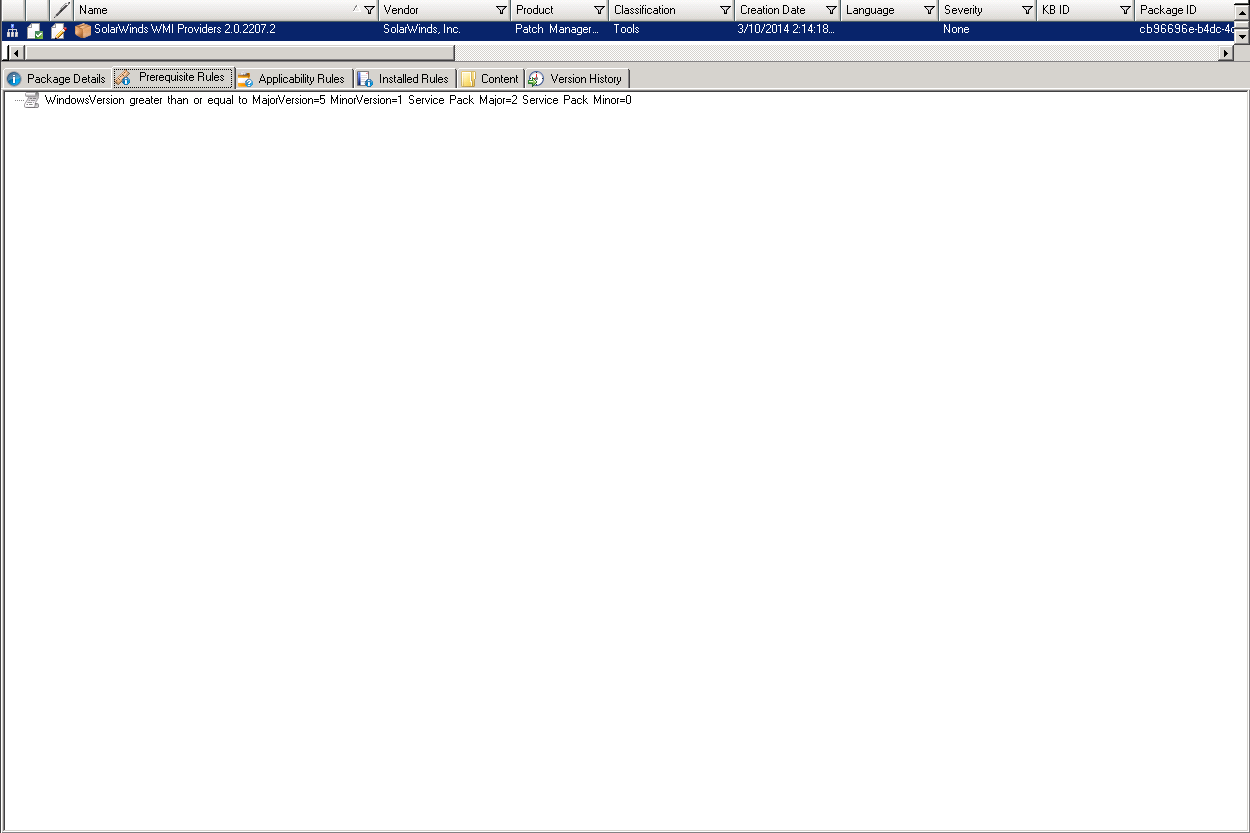

So now that we're all looking at the same screens, I can continue. There are a total of six tabs for every package; Package Details, Prerequisite Rules, Applicability Rules, Installed Rules, Content, and Version History. I'm only showing the first four above and I'm only going to deep dive on the tabs for Prerequisite Rules, Applicability Rules, and Installed Rules. I think of these rule tabs as answering very simple questions about the package:
- Prerequisite Rules
Does this program apply to the target computer as a whole? - Applicability Rules
Does this program apply to the installed software on the target computer? - Installed Rules
How do I know if this is already installed on the target computer?

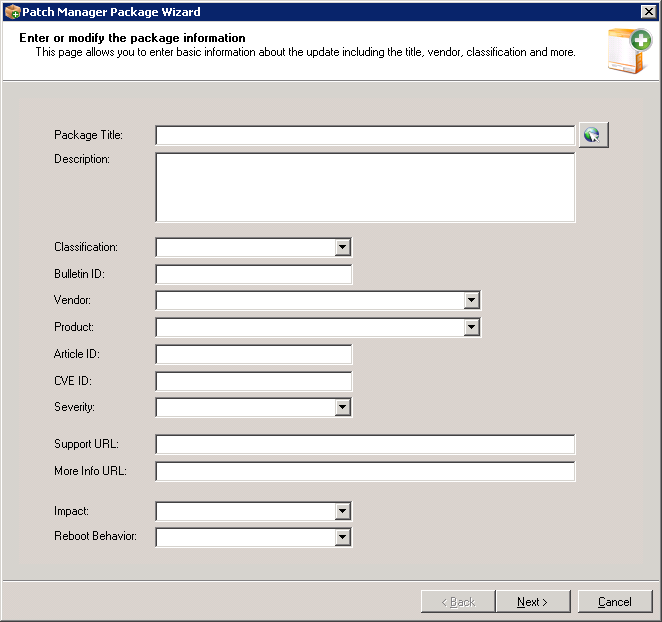

Package Information Screen
Now you are in the Package Wizard. (Click on the image to pop up a larger version of each)
Above are the minimum entries that you'll have to make for a package. Please be sure to change this for the proper version of the program. Please take note that the Product entry (where it says Orion Agent) needs to be hand-typed the first time that you run through the wizard. Once the information looks good, click Next to move onto the next screen.
What did we just do?
We just created the base information which categorizes the software package and how it is deployed. The two important fields here are the Impact and the Reboot Behavior. The Impact is used to determine the push schedule. If you have Allow Automatic Updates immediate installation setting within your Windows Update Policy set to True, and the Impact is set to Minor, the install can take place immediately at next check-in by the Windows Update Agent. If it is set to Normal, it is handled as all other patch tasks.
Reboot Behavior determines if the product requires a reboot. Many products will, but some may not. This is normally determined by the software package itself. The Orion Agent does not require a reboot, so we've selected Never Reboots.

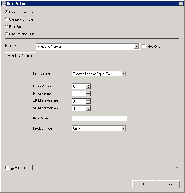

Prerequisite Rule Screen
Here is where having some background on the Rules is super helpful. From reading about the Orion Agent, we already know that it supports Windows Server operating systems with Windows 2008 R2 and later. It's also not recommended to be run on Domain Controllers. So with that in mind, let's build that rule.
On the Prerequisite Rule Screen, click Add Rule. Select Create Basic Rule as the format, and then Windows Version as the Rule Type.
- For Comparison, select Greater than or Equal to
- Enter 6 for the Major Version
- Enter 1 for the Minor Version
- Leave SP Major Version and SP Minor Version as 0
- Leave the Build Number empty
- Select Server for the Product Type
Click OK to save the rule and Next when you see the rule in the list.
In simple words, we just created a prerequisite rule that says "check the Windows Version of the target computer and verify that it is a Windows Server version 2008 R2 or later running on a Server." Windows version information (5.2, 6.0, 6.1, etc.) is explained a little more here. Additionally, if you feel that this rule could be used repeatedly, you could have checked the box and save the rule with a name (Like "Windows 2008 R2 Servers or Later").

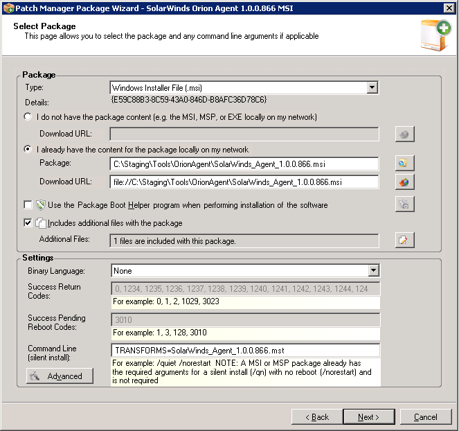

Here's where we tell the software how to install. With MSI files, it's pretty straight forward, but I'll run you through the process step-by-step.
- Select Windows Installer as the Package Type.
- Move the radio button under Details down to I already have the package, click the browse button on the right and browse to your MSI file.
- You will get a popup indicating that the package has been downloaded and then one which asks if you trust the package. Click OK to dismiss each of the pop-ups.
- Now take a step back. You'll see something new on this screen. The Product ID has been populated near the top (just under the Package Type). Select this and copy it to the clipboard. You'll need it in the next step.
- Further down in Details, check the box next to Include additional files with the package and click the package content button on the right side. On the select additional files screen, click Add File and browse to your MST File. Then click OK to close the Package Content Editor. Click on Yes to copy these files.
- Back on the Select Package Screen, select the Binary Language as None.
- Finally, enter TRANSFORMS=<Full Name of MST File> in the Command Line (silent install) field. This is the part where replacing spaces in the MST file with underscores (or something else) is handy. If you have spaces, you'll need to surround the MST file with double-quotes. This is one of the reasons that I saved the files with the names that I used above.
Here is your before and after...
When you are satisfied, click Next to continue to the Applicability Rules screen.
We have selected the type of installer (which determines the necessary command line parameters), the installer file, the transform file to be included, and then told that installer to use that MST file during install.
