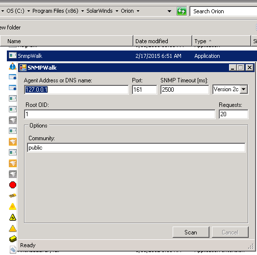

If you’re brave and curious, you can SNMP Walk the entire device to get a list of every single OID it supports. The best part? We ship an SNMP Walk tool with your Orion install – you can find it here:
[Install Drive]\Program Files(x86)\SolarWinds\Orion\SNMPWalk.exe
I’m an SNMP geek, so if I get into writing about how to read an SNMP Walk, you’ll never hear the end of it – so I’ll leave you with this handy guide on SNMP to get you started on reading the output and choosing the right OID from it to poll your device.

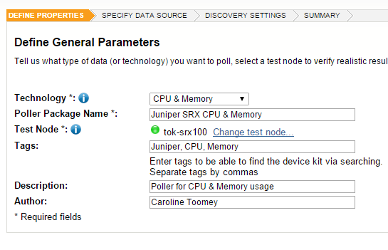

1. In Device Studio, click ‘Create New Poller’
2. Fill in the details about this new poller

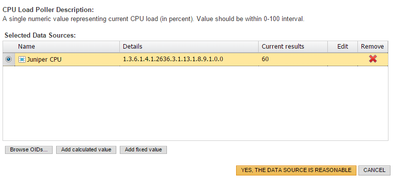

3. On the next page, you will see a list of all required information for this Poller. For example, to poll CPU & Memory, Orion needs to know where to get details of the current CPU load, Memory used and Free memory.

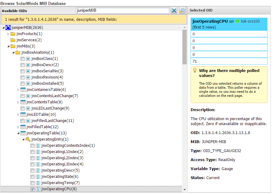

4. For each of these details, you’ll need to define the data source – this means, you’ll need to define what OIDs Orion needs to poll to get accurate information from your device.
5. You can browse the MIB tree itself, testing OIDs against your chosen device as you go.
Alternatively, if you already know the OID you want to poll, go ahead and enter it under ‘Manually Define OID’
6. Once you’ve chosen the data source, you’ll be asked to confirm if that data is reasonable and accurate. You’ll have the option here to perform calculations on the polled result – for example, to get an average across CPU cores, or combine multiple pollers together – this is very useful for Memory, as often, the data is stored as the number of blocks used / free – which then must be multiplied by the block size to get an accurate result.
If you’re happy with what you see, click ‘Yes, the data source is reasonable’.

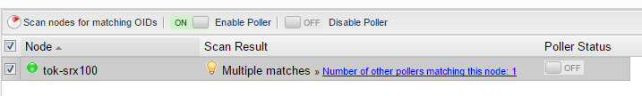

7. Almost there! Once you complete the wizard, choose your shiny new Poller from the list and select the ‘Assign’ button.
Select the node or nodes you need to assign this poller to, and run a Scan against them – this confirms that they will definitely support those new OIDs. If they pass the test with a Match, you can Enable your new poller, replacing the Native poller.

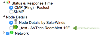

8. If you need to swap back again for any reason, just run a List Resources against the Node, and you can toggle back and forth between your pollers.

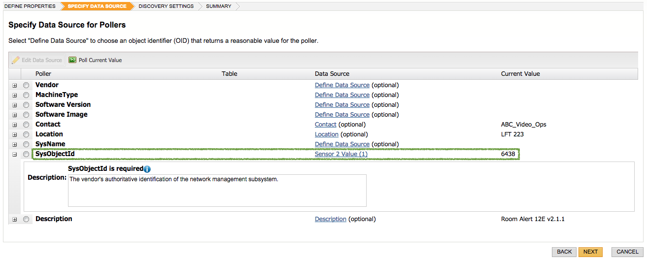

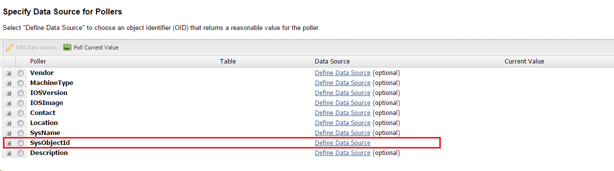

Much of the steps will be the same as above – you’ll just be creating a ‘Node Details’ Poller instead.
When you define the Data Sources for Node Details pollers, you’ll notice a lot of these are optional – but one is absolutely required: the SysObjectID.
The SysObjectID returns an OID that references another part of the MIB database – usually the Vendor’s MIBs, and can be used to identify both the Vendor and the Model of the device. It’s quite rare that this one isn’t supported by a device, so try to let Orion poll the SysObjectID automatically if at all possible. If the device doesn’t support this OID, you can use a constant value instead, and manually define the OID that should have been returned by the device.
Now, with the required OIDs done and out of the way – you can move on to fixing that Vendor = Unknown problem – and that part is quick and simple. Set the Constant Value to the text string you want it to report for both the Vendor, and the MachineType.
