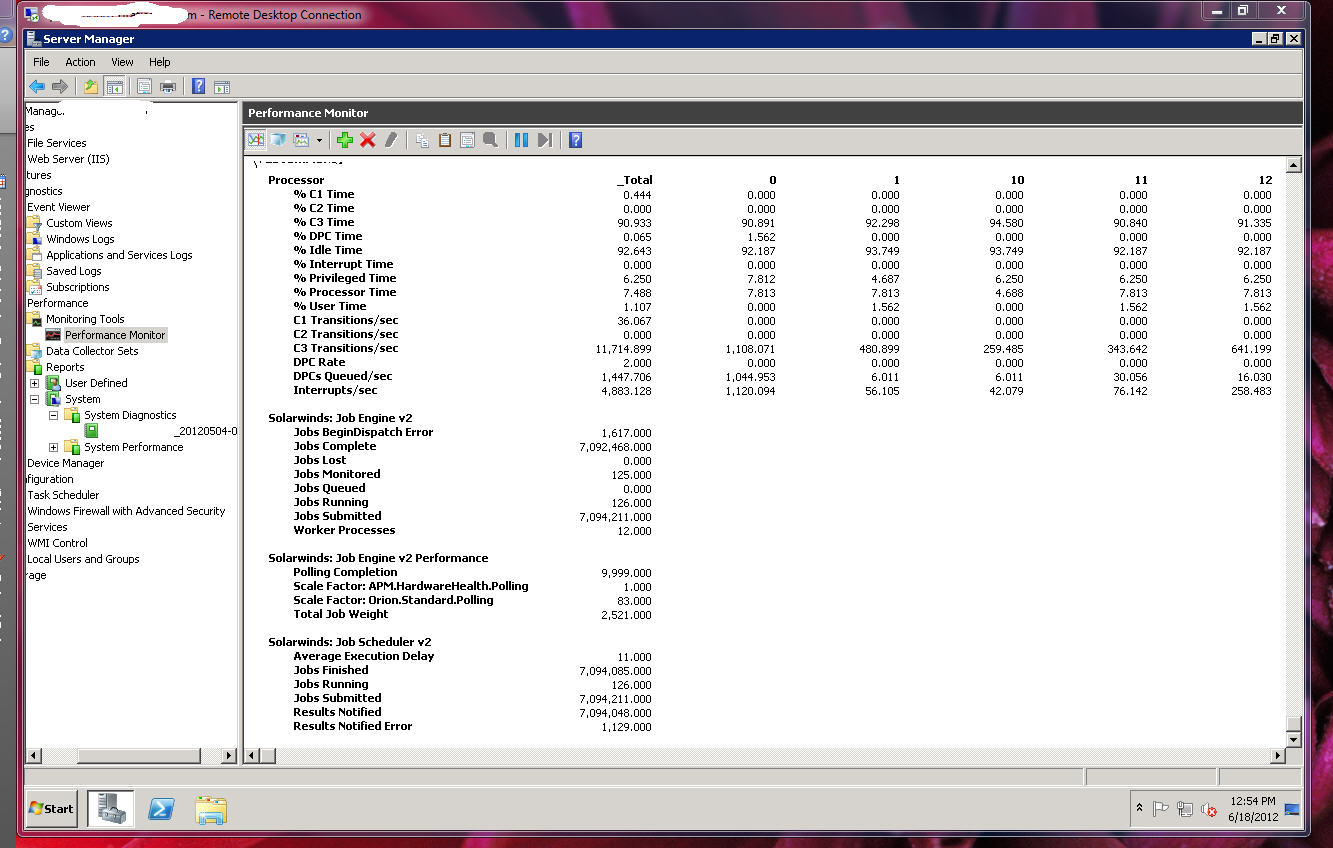

If you really want to understand what is behind the new poller then the best way to monitor performance of polling, results processing and storing results to DB are performance counters.
This is the complete list of all available counters related to the new poller. If you need to double check your performance status you should watch mainly following items:
DPPL waiting items – this counter should not be growing constantly in time. Ideally it should go to zero in between polling intervals. If this value keeps growing your polling results are not being proceed in the expected time and you can see gaps in charts or in poll reports. This is usually caused by slow hardware. (DDPL means Date Processor Pipe Line)
DPPL Avg. Time to Process item – reflect the time of writing polling results to DB. The optimal value should be less than 0.500(ms) otherwise you will experience noticeable delays between result processing and storage to database.
Scale Factor: Orion.Standard.Polling - represents scale factor/polling rate I mentioned above. It can tell you if the system is using throttling or not and what the current utilization is.
Messages in Queue – if this value is persistently growing then it means you are not able to process all poll results on time. This is usually because of slow hardware. But also database connectivity and performance play a key role in the ability for the collector to store results and can result in a queue backup.
If you run “perfmon” from windows start menu command line and paste (use CTRL+C and CTRL+V) attached counter list into performance monitor window on your Orion server you will see all the counters related to polling performance:
[View:/cfs-file.ashx/__key/CommunityServer.Components.UserFiles/00.00.03.32.84/countersProperties.txt]
