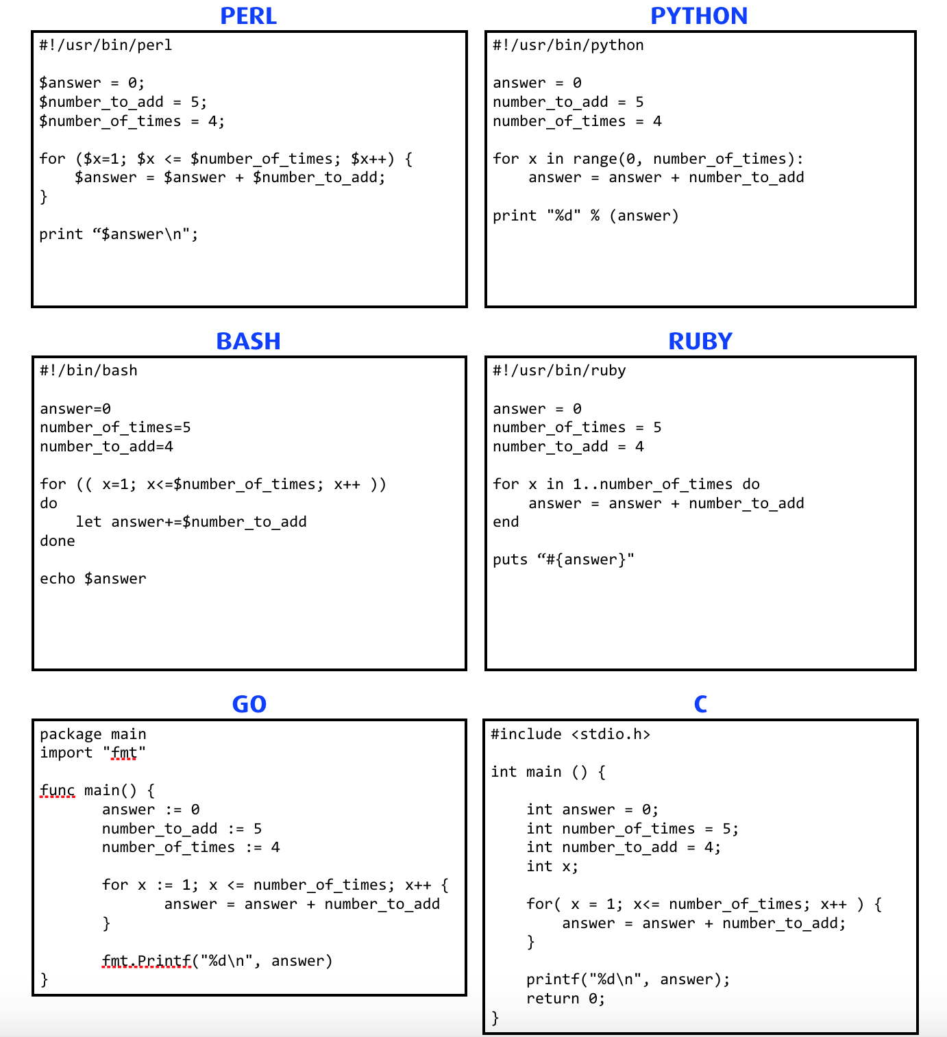

This is a pretty low level example that doesn't achieve much, but understanding the logic of the steps taken is something that can then be implemented across multiple languages:
I will add (before somebody else comments!) that there are other ways to achieve the same thing in each of these languages. The point I'm making is that by understanding a logical flow, it's possible to implement what is quite clearly the same logical sequence of steps in multiple different languages in order to get the result we wanted.
