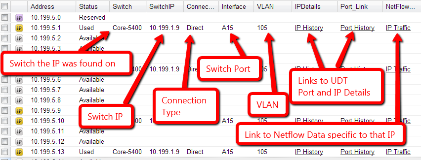

IPAM and UDT already have this data so we prepared a small script that can help you to see port, AD account or port history link directly in one row in IPAM. So the output may look like this:

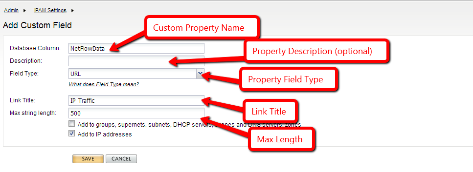

- Create ALL of the following REQUIRED custom fields/properties in IPAM exactly as you can see below:
Populated by - UDT
- 1. Switch
- a. Field Type - Text
- b. Max String Length - 100
- c. Description - Name of the Switch the IP is plugged into
- 2. Port_Link
- a. Field Type - URL
- b. Link Title – Port History
- c. Max String Length – 500
- d. Description – Link to Port Details in UDT
- 3. Interface
- c. Description – Interface name where the IP was last seen
- 4. ConnectionType
- c. Description – Direct vs Indirect connection
- 5. VLAN
- c. Description – VLAN the IP belongs to
- 6. MACAddress
- c. Description – MacAddress for the IP
- 7. SwitchIP
- c. Max String Length - 100
- d. Description – IP Address of the switch
- 8. IPDetails
- c. Max String Length - 500
- d. Description – Link directly to the IP Details in UDT
- 9. ADAccount
- c. Description – AD Account most recently logged in
- 10. AccountLogonTime
- c. Description – Login Time
Populated by - NTA
- 1. NetFlowData
- b. Link Title – IP Traffic
- d. Description – Link to Netflow data filtered for the IP
Populated by - VNQM
- 1. Extension
- c. Description – IP Phone extension in VNQM
- 2. PhoneDetails
- b. Link Title – Phone
- d. Description – Link Direct to IP Phone details in VNQM
Populated by – NCM
- 1. NCMID
- b. Link Title – NCM Node
- d. Description – Link Direct to NCM Node Details
- 2. NCMConfig
- b. Link Title – Config
- d. Description – Link Direct to NCM Config

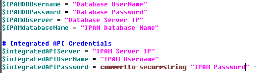

Now it's time to open the script and fill in credentials and variables (the pink text in the image below):
- IPAMDBUsername – The username used to connect to the IPAM Database
- IPAMDBPassword – The password used to connect to the IPAM Database
- IPAMdbServer – The IP address of the IPAM Database server
- IPAMdatabaseName – The Name of the IPAM Database
- integratedAPIServer – The IP address of the IPAM server
- integratedAPIUserName – Account used to login to the webconsole - with permissions to all modules
- integratedAPIPassword – Password used to login to the webconsole
Once you prepare your credentials you can run the script.

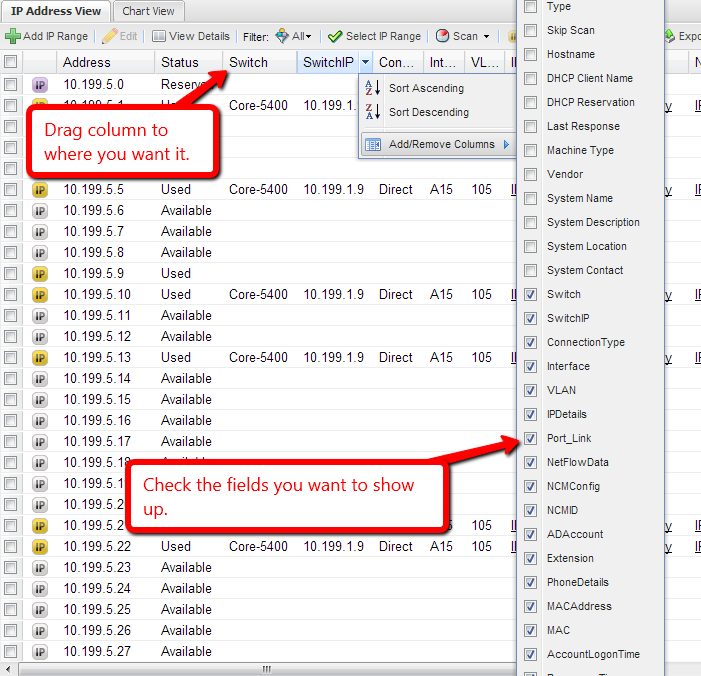

The final step is to configure the UI and display your new columns in the IP Address view. Click on the column and select new custom properties from the list.
