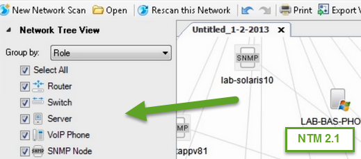

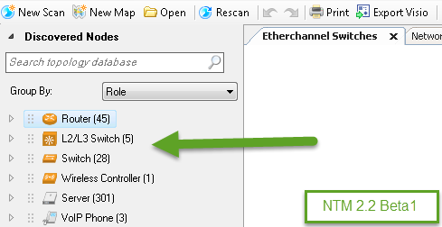

- Not sure what connects to the nodes on your map? Try right clicking and selecting "Add Neighbors".
- How do you interact with multiple topology databases at the same time? A drop down in the application? Multiple levels of tabs? Yuck. In this beta, for the first time, you can open multiple instances of NTM.
- Each NTM instance holds all the maps for one topology database.
- If you have two topology databases open, you can scan in one window and continue working in the other.
- If you have three topology databases open, you can scan in two windows (parallel scanning) and continue working in the remaining one.
- Shortcuts allow you to add intelligent groupings of nodes to your map all at once.
- Select nodes in the map you're looking at intelligently by clicking on individual nodes, groups of nodes, or node shortcuts in the left hand pane. For example, selecting the "Router" group in the left hand pane selects all routers on your current map.
- Connection jumps.
- Copy paste nodes or groups of nodes between your maps. Layout is preserved.
- Improved Credential Management UI.
- Extensible regex interface name handler to intelligently shorten interface names so they fit well on the map.
