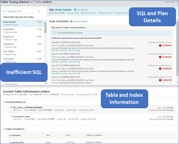

The Table Tuning Advisor page has three main areas:
- Inefficient SQL – a list of queries accessing the table ranked by relative workload.
- SQL and Plan Details – SQL and Plan details for the selected query.
- Table and Index Information – current table information, existing indexes on the table and the table’s columns.

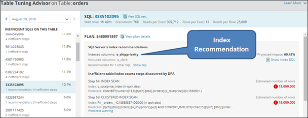

Are there any recommendations to use as a starting point? Clicking on the “orders” table takes us to the Table Tuning Advisor page that provides details about inefficient queries accessing the table. This page pulls together what you need to know about the table regarding inefficient usage patterns, statistical information, design of current indexes, and much more. Index recommendations appear near the top of the page and may provide a good starting point for a solution.
Which steps in the plans are inefficient and does it align with the recommendation? DPA uses a proprietary algorithm to find plan steps that are inefficient and causing issues. Inefficient “producer” steps (for example, full table/index scans) read data to be processed later by subsequent "consumer" plan steps. While consumer steps (for example, sorts) can have a high plan cost, they are usually affected by a preceding producer step that read too much data. DPA can point out the inefficient producer plan steps that should be the focus of tuning efforts.

- INDEX SCAN – Step 64 – A full scan of the o_totalprice_index index. Notice the predicate value that shows a function named CONVERT. The query is using a CONVERT function against the o_totalprice column which will often negate effective use of an index. An INDEX SCAN reads the entire index, which is why the step shows 15 million rows associated with it.
- CLUSTERED INDEX SCAN – Step 69 – A full scan of the orders table. Notice the CONVERT_IMPLICIT function within the predicate value. This indicates an implicit conversion, i.e., data type mismatch, and DPA displays a predicate warning as a result. Click on the warning to get additional information. Other potential warnings include:

Based on the data shown by DPA in this example, the index recommendation may help tune the clustered index scan in step 69. However, tuning step 64 will likely require a modification to the query to remove the CONVERT function on the o_totalprice column. Gleaning this information via manual plan analysis would probably take hours. Plan analysis is difficult, so let Table Tuning Advisor help get you to a good starting place.

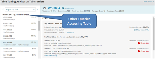

Are there other inefficient queries that access this table? The left pane of the Table Tuning Advisor page shows other inefficient queries, ranked by relative workload, accessing the “orders” table. Pay attention to the queries near the top of this list because they cause more workload against the table. Conversely, you should not spend as much time on queries near the bottom with small relative workloads. These queries could be affected by a new or modified index on the table.
