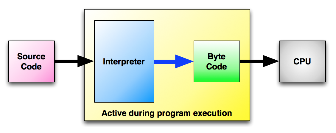

Interpreted
An interpreted language is one where the language
reads the script and generates machine-level instructions on the fly. When an interpreted program is run,
it's actually the language interpreter that is running with the script as an input. Its output is the hardware-specific bytecode
(i.e. machine code). The advantages of interpreted languages are that they are typically quick to edit and debug, but they are also slower to run because the conversion to bytecode has to happen in real-time. Distributing a program written in an interpreted language effectively means distributing the source code.

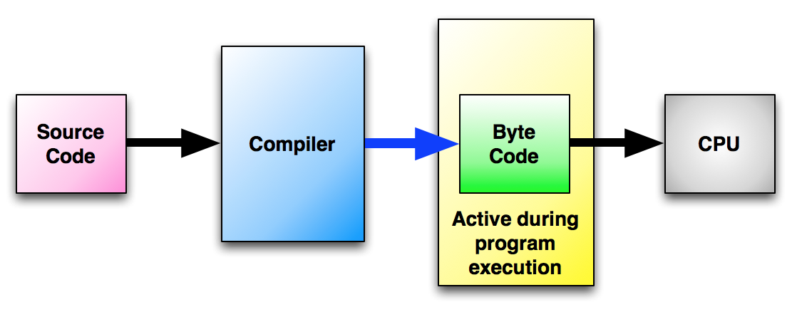

Compiled
A compiled language is one where the script is processed by the language compiler and turned into an executable file containing the machine-specific bytecode. It is this output file that is run when the script is executed. It isn't necessary to have the language installed on the target machine to execute bytecode, so this is the way most commercial software is created and distributed. Compiled code runs quickly because the hard work of determining the bytecode has already been done, and all the target machine needs to do is execute it.
