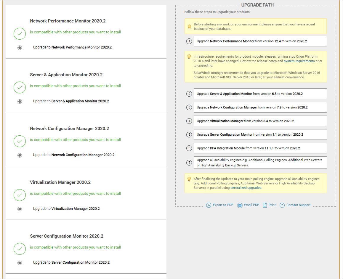

Since I was two major revisions behind on most of my products, I decided to add a little extra time in planning. I started by looking at what SolarWinds recommended for my upgrade process by using the Upgrade Advisor.
Upgrade Advisor
I jumped into my customer portal and opened the Upgrade Advisor. I put in the necessary information about my existing system and the target upgrade.
After submitting, I was given a step-by-step list of what needed to be done to bring me up to the selected version numbers.
For anyone interested, I’ve attached the PDF export of my upgrade advisor, so you can see what I was using as my guide. This made writing up my change management request super easy. I could just attach the PDF.
The summary of the upgrade plan is this:
- Upgrade NPM from 12.4 to 2020.2
- Upgrade SAM from 6.8 to 2020.2
- Upgrade NCM from 7.9 to 2020.2
- Upgrade VMAN from 8.4 to 2020.2
- Upgrade SCM from 1.1 to 2020.2
- Upgrade DPAIM from 11.1.1 to 2020.2
- Upgrade the scalability engines using the Centralized Upgrade
