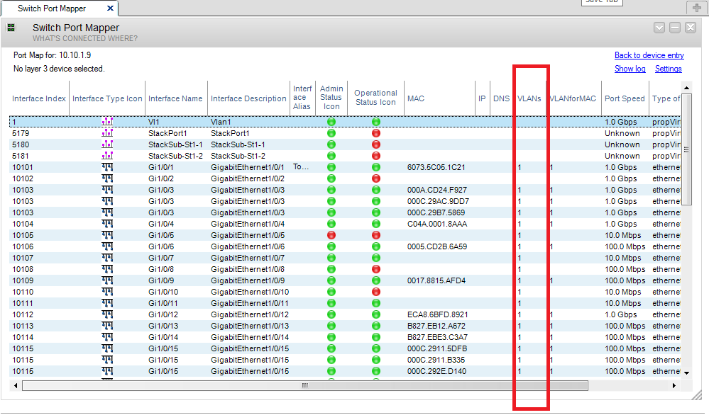

- Switch showing only VLAN1 - Only occurs due to SNMPv3 mis-configuration; see vendor document above.

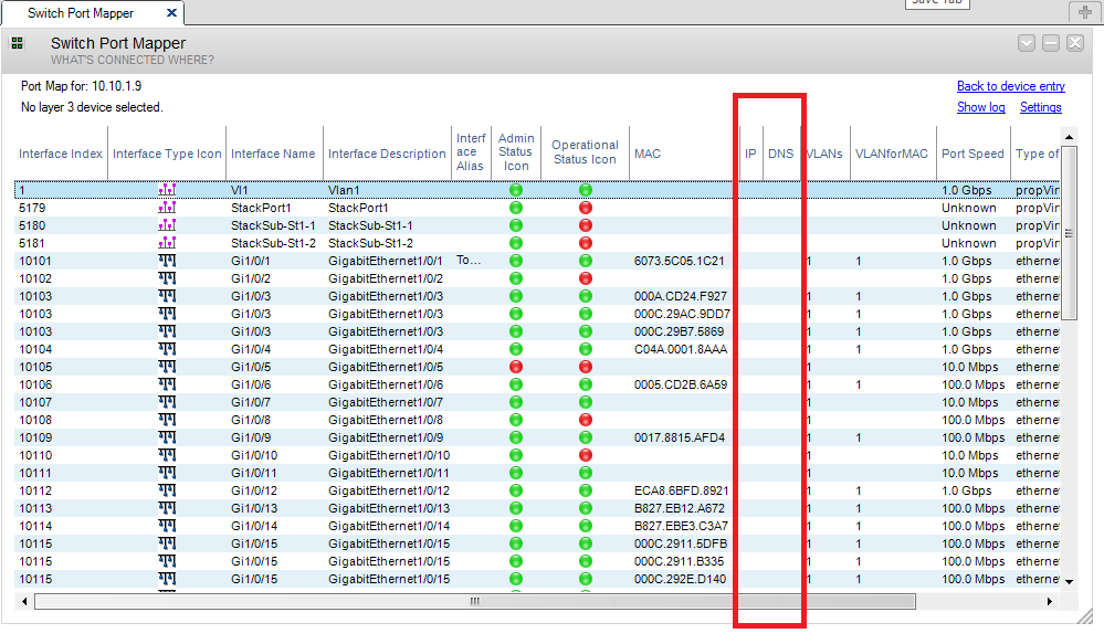

- Router with IP information missing - Add Router and rescan and this will be corrected. This router needs to be in the Product to show this information properly

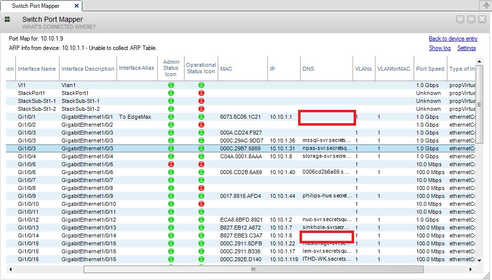

- Hostname information missing - DNS Records missing on the DNS Server.

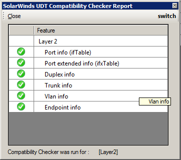

- Once this completes, select the Report Button. This is a Pass/Fail for each Section.
Note: This is a successful scan of a working switch checking for Layer 2.

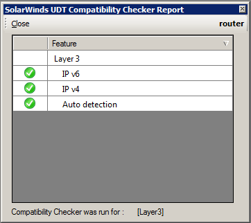

Example of Correctly Configured Layer 3
If you are see any Red Xs, please check the SNMP configuration, or go into the Toolset Troubleshooting area of this document.
