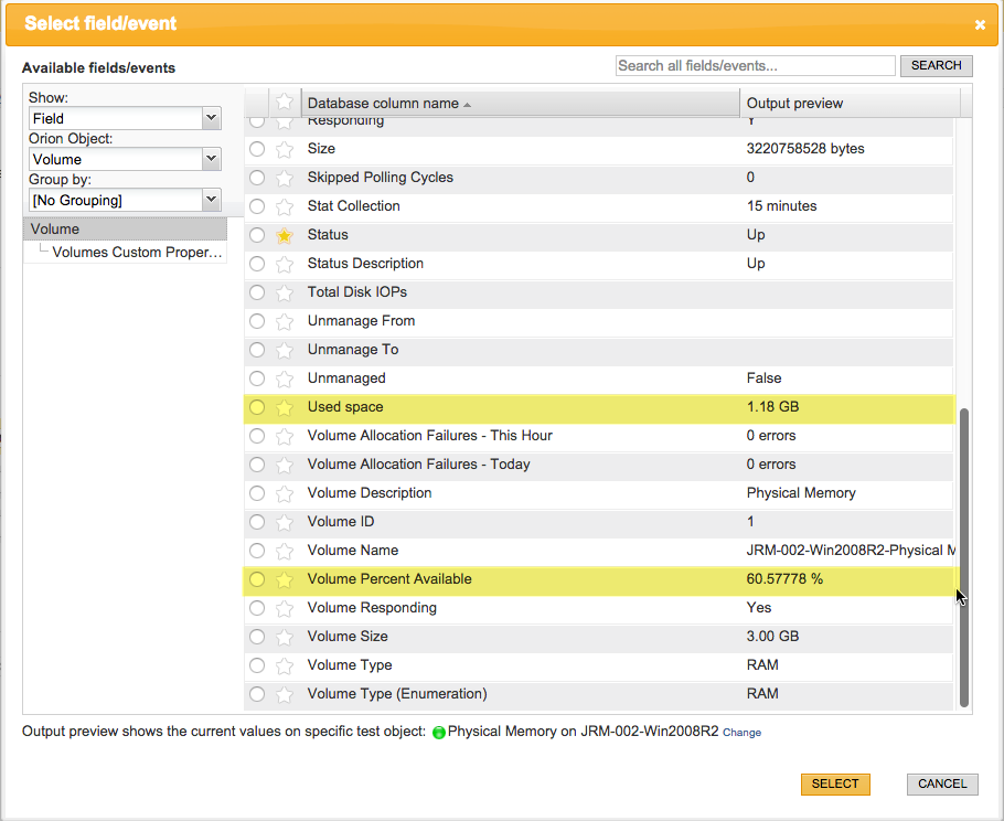

I am trying to write some code that will report on the number of sessions in the XenApp 6.0 estate marked as 'Down'. This is the first PowerShell I have tried to put into Solarwinds and need direction.
Below is the data I can see at this time?
I have put together some code together below which reports back exactly what I require. I am looking to get the total down sessions in the estate and also the users names. Here is the code:

When I then paste this isto the template caretor and click the 'Get Script Output' button I get no errors and get a result of not defined. I am running the script remotely against a XenApp 6.0 server which I have confirmed the PowerShell addins exist on.
Can someone point me in the right direction as this script will be used as a template for a load of other outputs we require?
