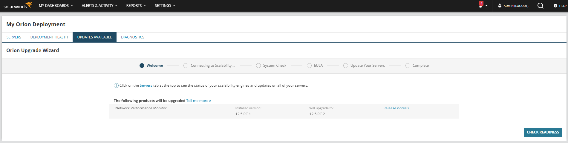

In the example below, I have an installation of one main polling engine installed with NPM 12.5 RC1 with the intent to go to RC2.

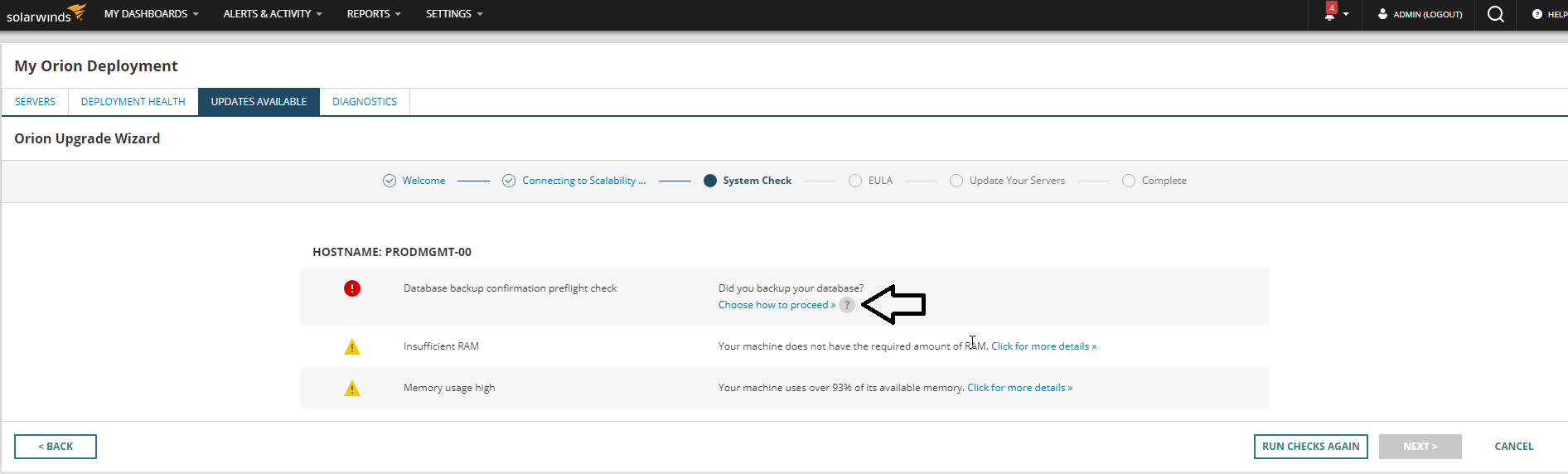

I'm going to click "Check Readiness" to proceed. I don't have scalability engines so the wizard will skip past the second step and immediately start with preflight checks.

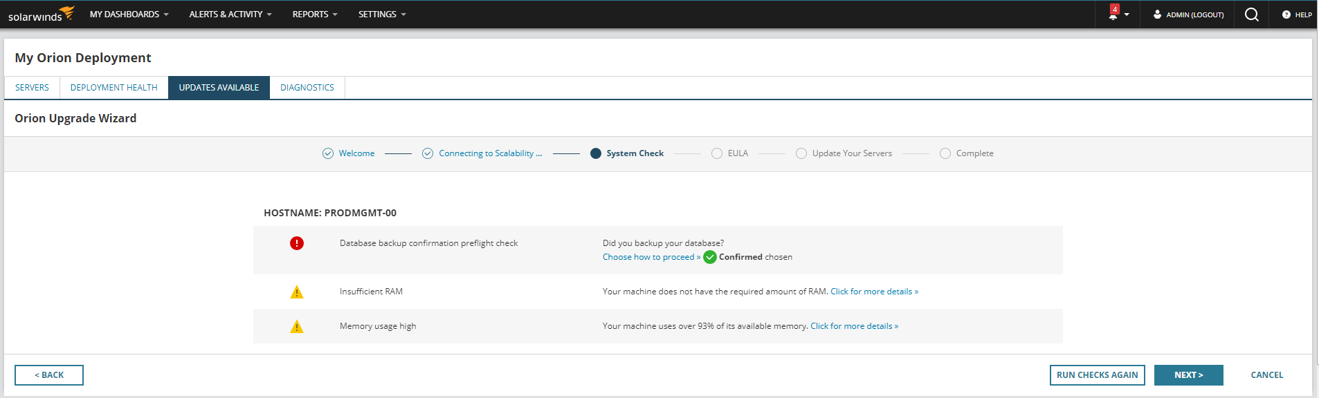

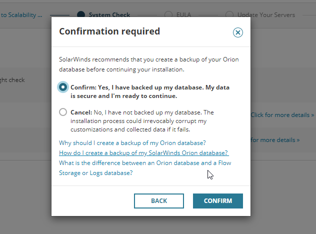

Make sure you confirm that you've backed up your database and addressed any potential issues found.
Click 'Next' to proceed to the EULA.

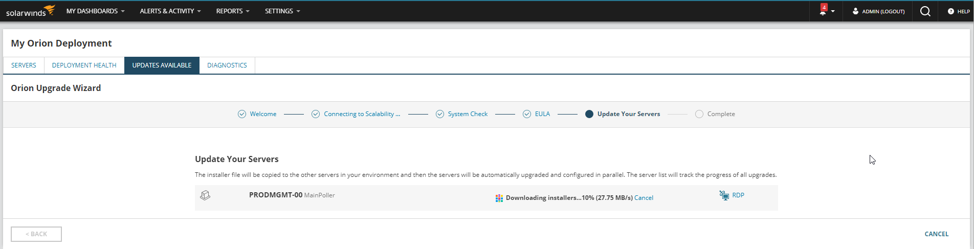

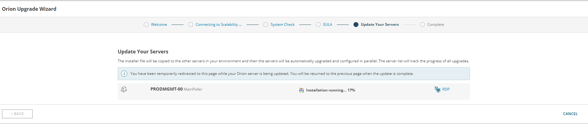

After accepting the EULA, your upgrade will begin.
While installation is occurring, clearly your main polling engine will be down during the upgrade, so how will you get insight into the progress of your upgrade during this time? No worries, you'll be seamlessly redirected to a SWA hosted page that looks like the following
If you close the browser window for any reason, you can always navigate back to this page by RDPing into the main polling engine and clicking on the My Orion Deployment shortcut in your programs.

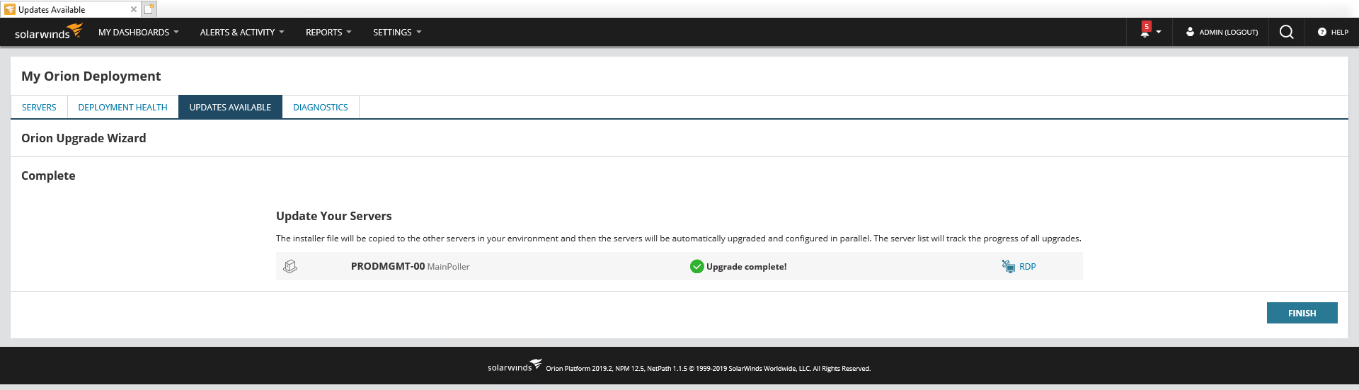

In due time, you will be redirected back to the My Orion Deployment page when the main polling engine is fully upgraded and available.
Now all customers on the Orion Platform 2019.2 and higher will be able to enjoy all future upgrades from the comfort of their web browser.

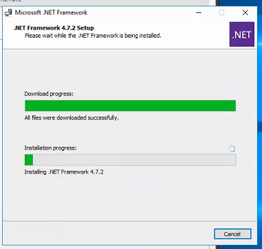

Updated .NET Requirement

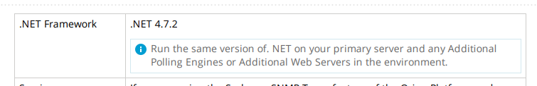

While preparing for your upgrade, review the system requirements for Orion 2019.2.
For instance, you may need to update your .NET version to 4.7.2 on all of your Orion servers.
