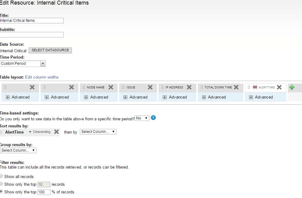

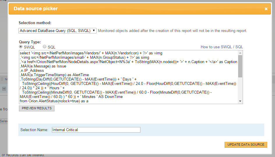

*****NEW****** Nice Heads up Display Board
The below strictly work under the condition that you have your alerts writing to NetPerfMon and you DO NOT SET the title of the alert action for Write to NetPerfMon and let solarwinds default it to the message you typed in when you save it with a blank title.
Given all the new upgrades and movements of tables and db schema changes recently with NPM and the introduction of SRM I've come up with new Critical and Action item scripts.
I've also moved them to a Stored Procedure as well instead of a view or report this is much faster, more accurate and easily executed.

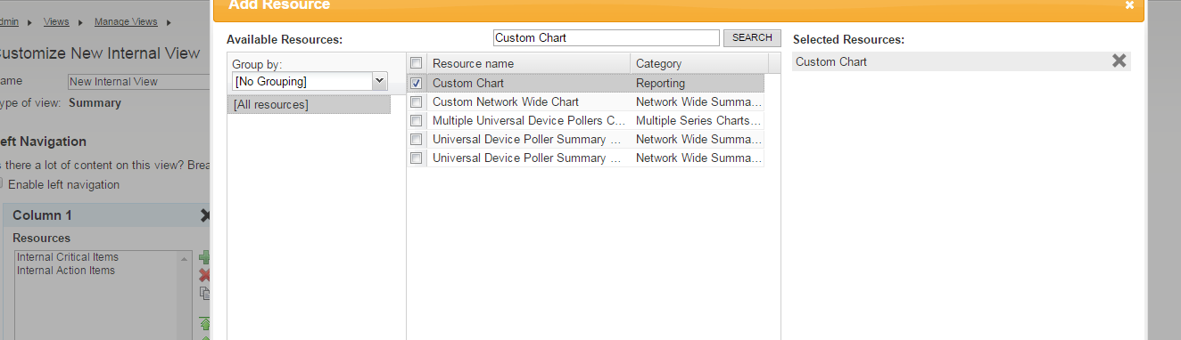

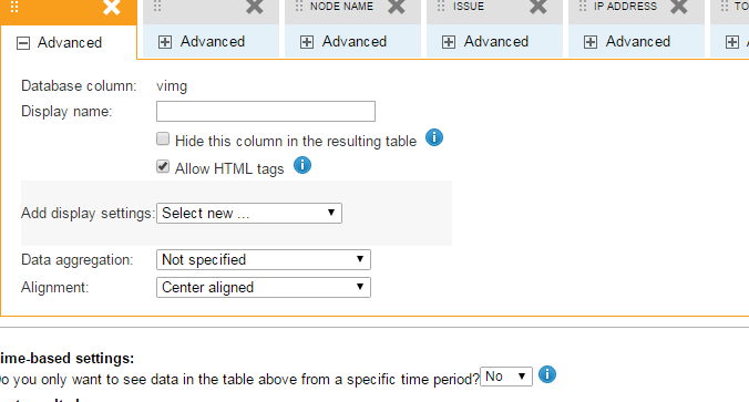

To add these to a view or resource in your web console you just need set the resource as an Advanced Database Query select SQL for the Query Type and put in the execute for the stored procedure as the screen shot below
This is the script for Critical Items (This also gives a status of how long its been critical)
