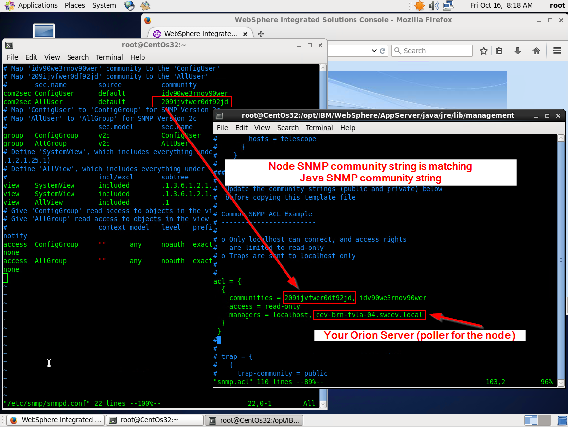

IBM WebSphere uses its own JDK, installed at %WEBSHERE_HOME%\java (where %WEBSHERE_HOME% is the path to your WebSphere installation).Configure the IBM JDK in the following manner:
- Go to the $JAVA_HOME/jre/lib/management folder.
- Rename the snmp.acl.template file to snmp.acl.
- Edit snmp.acl by replacing its content with the following:
acl = {
communities = SAME_COMMUNITY_STRING_AS_CONFIGURED_FOR_SYSTEM_SNMP_DAEMON
access = read-only
managers = localhost, APM_SERVER
Where APM_SERVER is the hostname of your APM server. - Grant access to the snmp.acl file only for the root user. Run the following commands as the root user in your shell:
# chown root.root $JAVA_HOME/jre/lib/management/snmp.acl
# chmod 600 $JAVA_HOME/jre/lib/management/snmp.acl

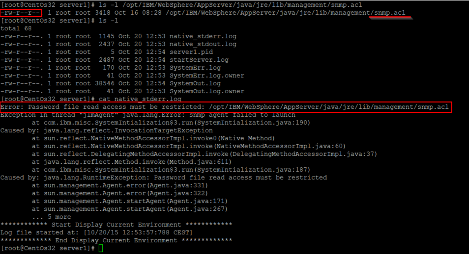

Without this change SNMP doesn't work and fails with exception "Password file read access must be restricted"

Troubleshooting:
If any errors occur during start up of the SNMP agent, the Java VM will throw an exception and exit.
Configuration errors include the following:
- Failure to bind to the port number - Error: Failed to start SNMP adaptor with address: /0.0.0.0:1161 (Address already in use)
- The password file is readable by anyone other than the owner.
- Invalid snmp.acl file - Error: Exception thrown by the agent : Encountered .... at line ...., column ....
Example of error message in logfile, when wrong access level to snmp.acl file granted:
