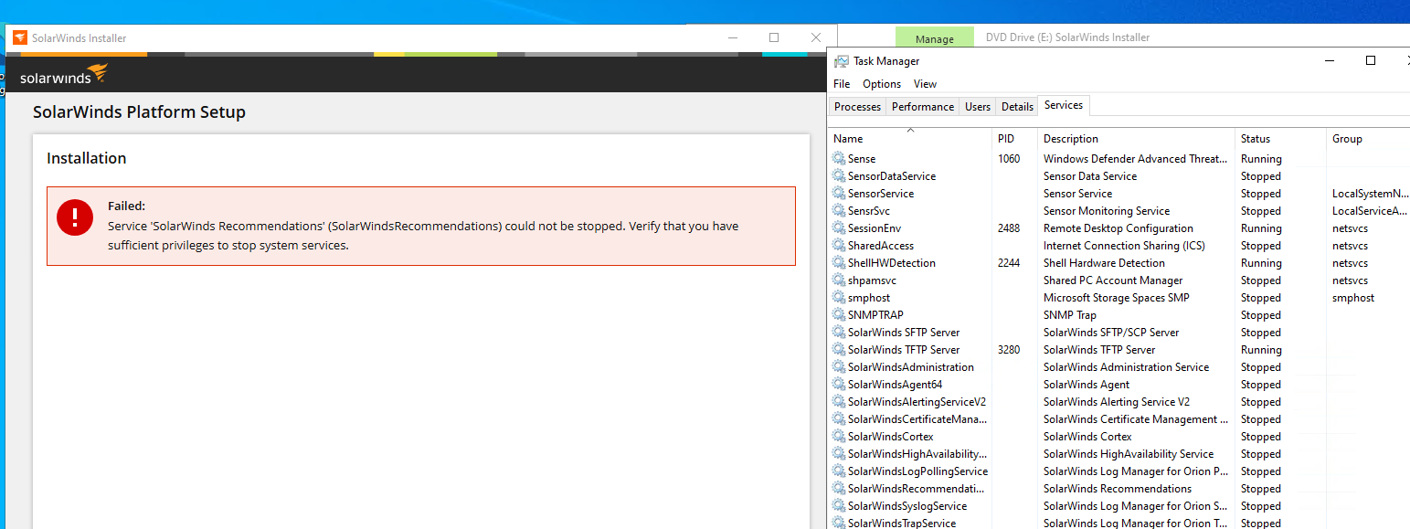

When performing the install the SolarWinds installer prompted me with an error stating it was not able to stop the SolarWindsRecommendations service due to some permissions issue.
I've been a SolarWinds admin for over a decade and have not seen this error before. The service is locked for permissions at the system level. I was not able to use PSExec or any other utility to stop the service.
When I disabled the service from the registry at startup the SolarWinds installer STILL failed with the error. Even though in the screenshot below you can see the service is indeed not running.

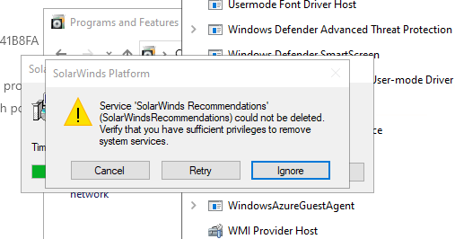

I ended up performing an uninstall of all SolarWinds products. At this point I was still met with the error that the service could not be uninstalled! Image below.
I had to ignore the error in the uninstaller and just let it complete. I then went and deleted the service from the registry, deleted the SolarWinds folders from the install directory and ProgramData. Then rebooted the server.
