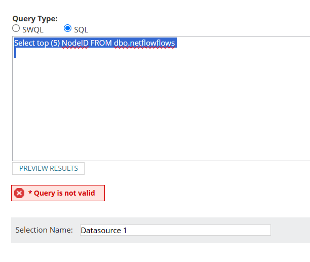

I'm trying to query my NetFlow database but keep getting a message that indicates the query is invalid.

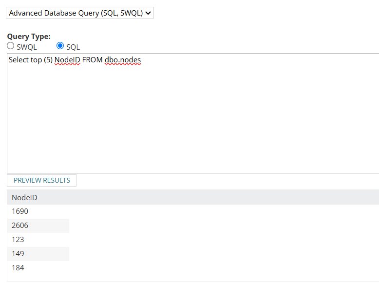

A basic query to the Orion database works.
Select top (5) NodeID FROM dbo.nodes
A basic query to the FlowStorage data base fails.
Select top (5) NodeID FROM dbo.netflowflows
I have tried brackets on the dbo and table as well as including the database name in the query and nothing is working

Does anyone know what could be blocking my query to the netflow database when building a report?

2024-12-13 14:53:20,218 [579] (29) ERROR SolarWinds.Orion.Core.Reporting.DataTableQueryBase - (null) Errored query dataSource: Datasource 1/93f0292e-88c6-4456-a9eb-ff47b744afa2 Query:Command:SELECT TOP (5) NodeID FROM [SolarWindsFlowStorage].[dbo].[NetFlowFlows]
