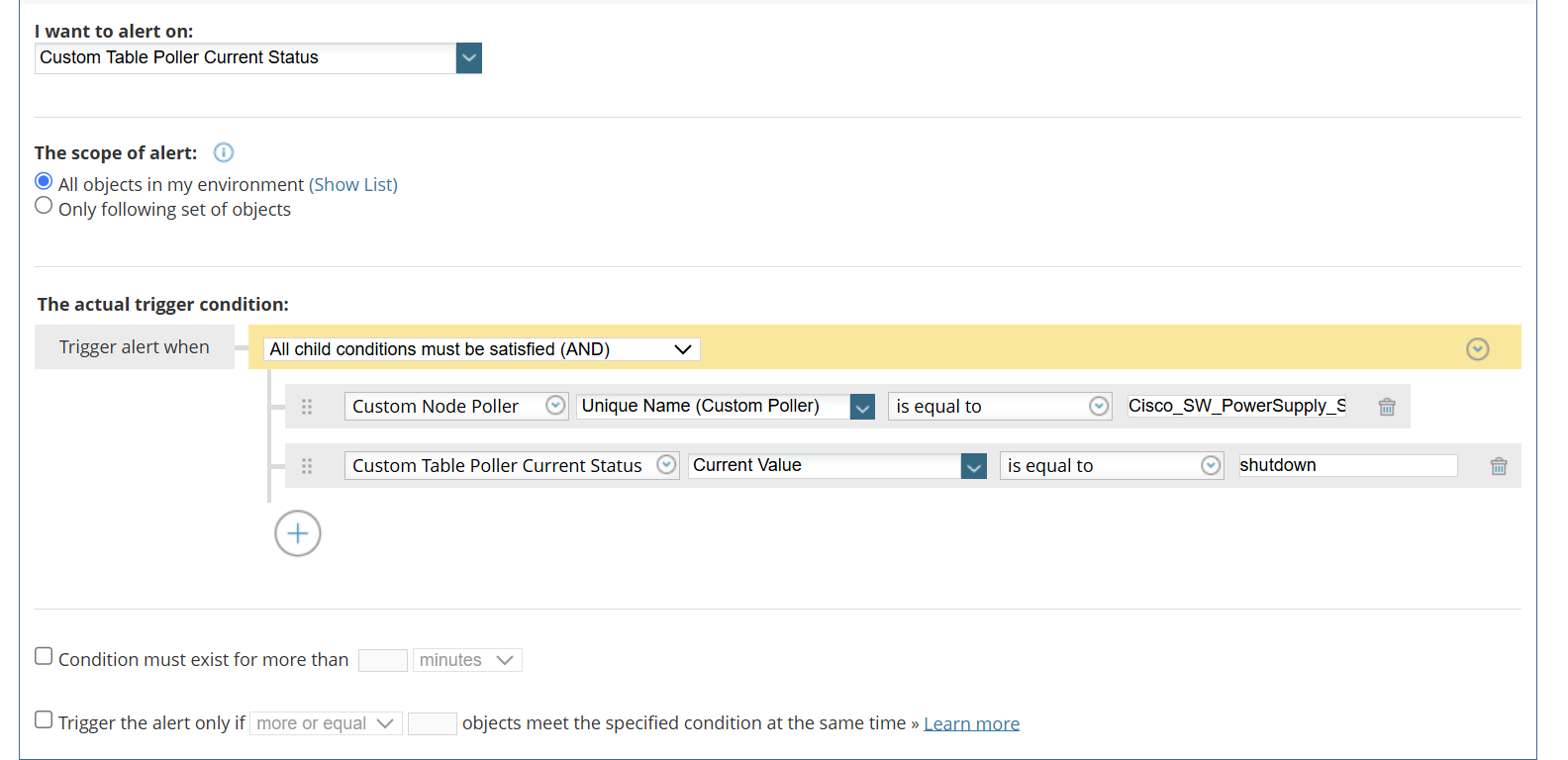

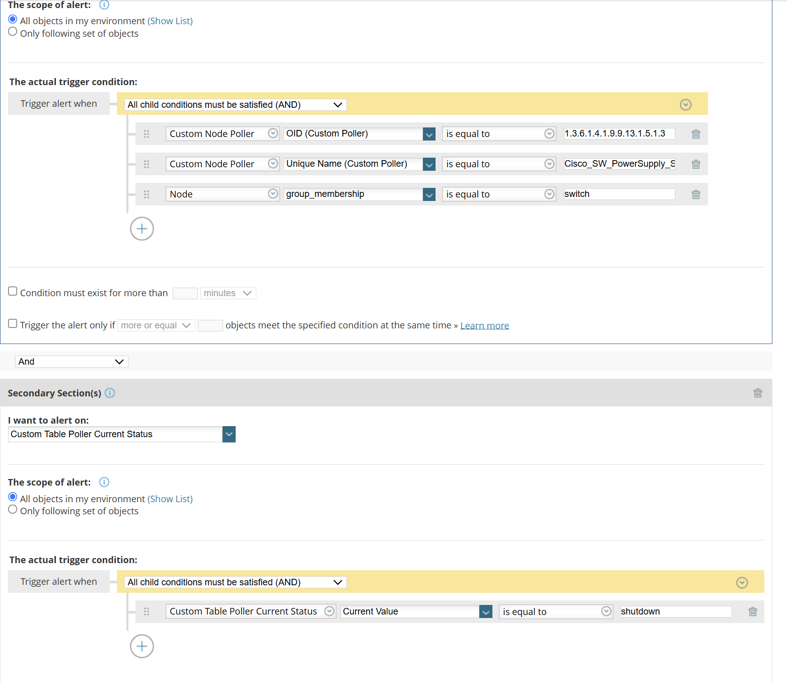

My trigger condition
I'm using advanced condition to have Node, Custom Puller and Custom Table Puller options for condition and for alerting.
Simply speaking. if only Custom Table Puller is used i cannot limit it to node, custom_properties, end similar. Also, it will not permit testing trigger without
changing power supply status directly in solawinds db.

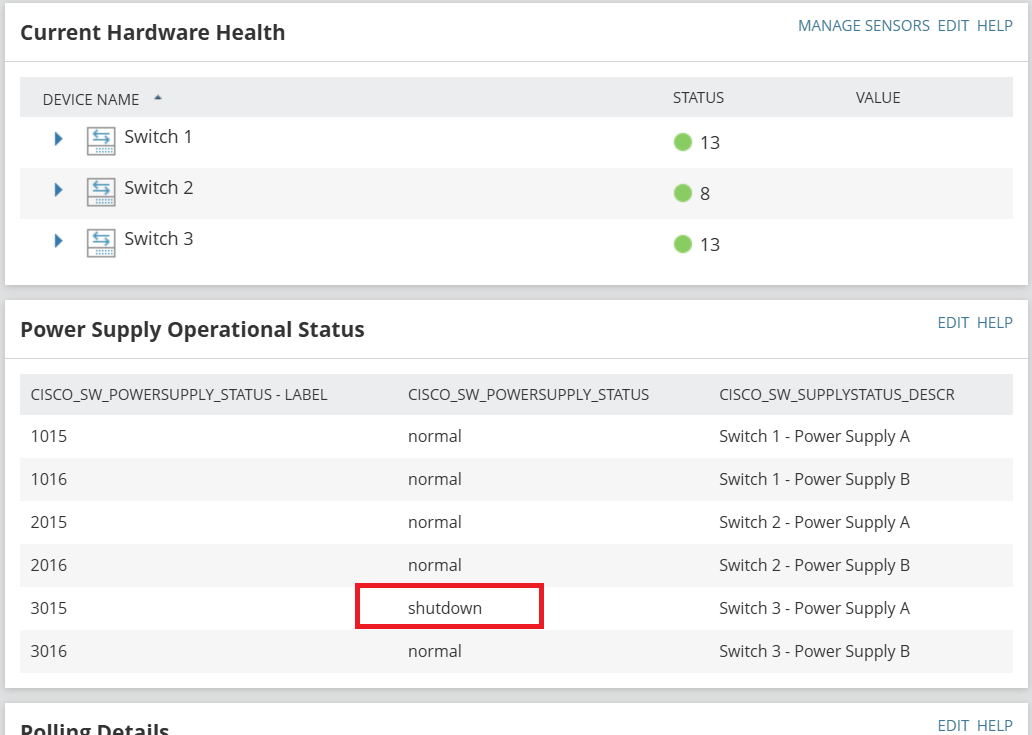

The issue when power supply status changes to shutdown on one switch, alert is sent for each switch with this UnDP assigned, I'm getting individual
alert for all switches even though they have status on all power supply - normal. The same is on reset alert. I'm getting reset when switch with issue on power supply cleared.
But i'm getting for all switches. one alert per switch
Please help to understand why.

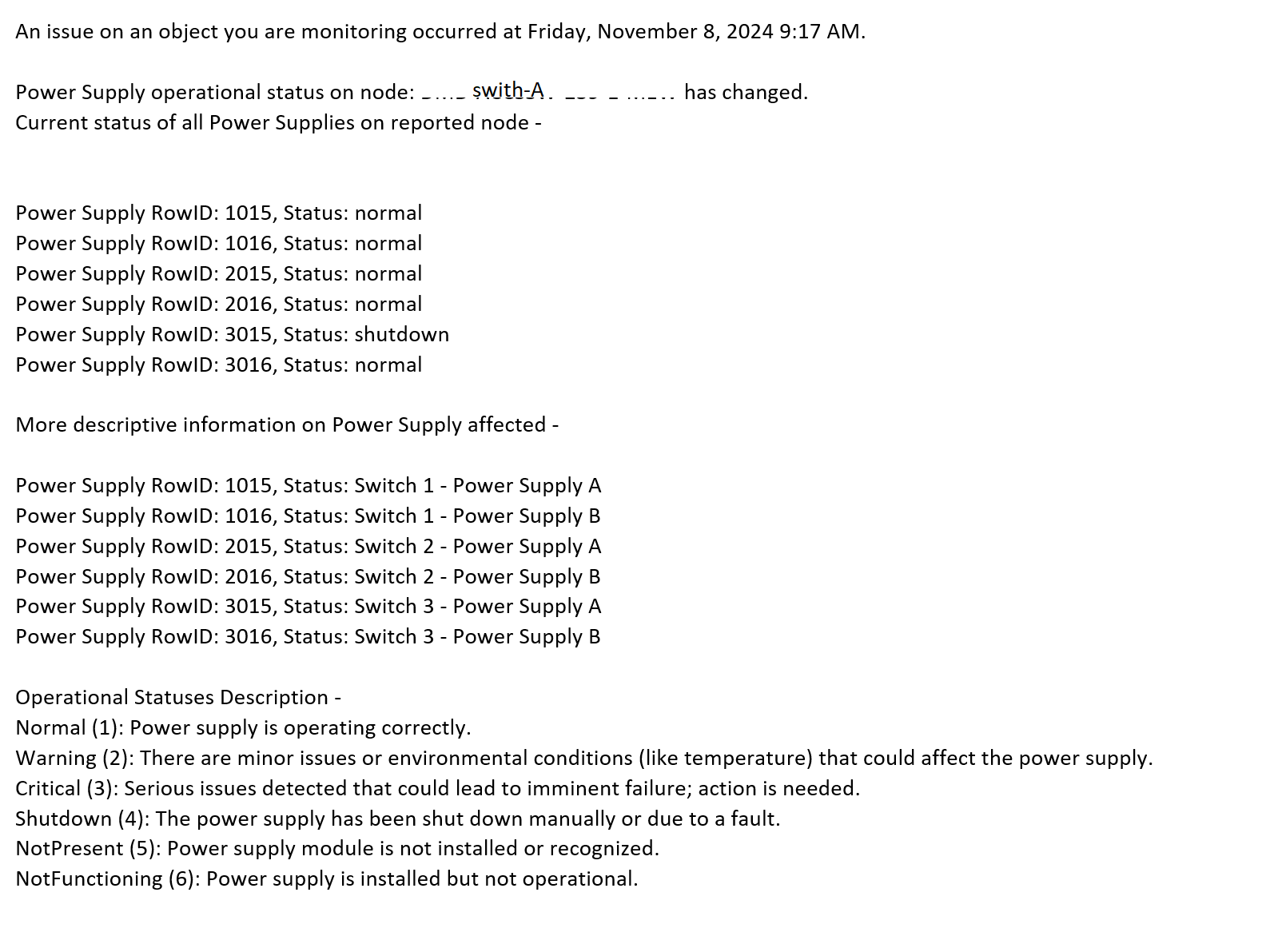

Triggered alert of swiith with issue. Ignore that Puller Supply RowID show all normal. it was triggered by changing status to 4 in db

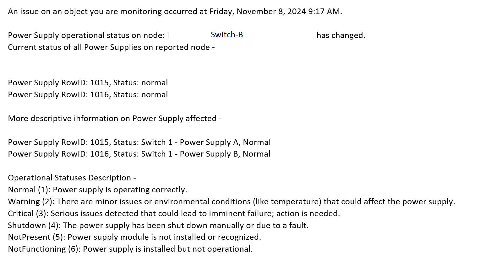

Aller which comes also for one with normal status on all.
Triggered swith
But on second alerted unit both power-supplies have normal.
Alerting works fine when trigger condition is set as on next pic
This monitors only power-supply condition and not power-supply on node as on the first one. but I'm having problem to write alert message to show status of each
powers supply and node on which it is installed.
In addition, it doesn't permit to test trigger. only directd db value change triggers eval condition. I don't mind this but it take longer.
