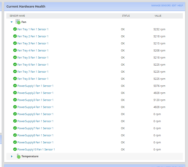

Running on 2024.1.1 with 800+ Arista devices and none of them detects Arista Power Supply (it detects only the PowerSupply Fan sensor)
Ex: we want to list the below power supply with their operational status on the "Hardware Health" page

The power supply aren't showing up either on the "Manage Hardware Sensors" page

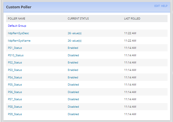

For the PSU operational status, should use
AMER-NY1-F15-SW1(s1)#show snmp mib walk 1.3.6.1.2.1.131.1.1.1.3.100711000
ENTITY-STATE-MIB::entStateOper[100711000] = INTEGER: enabled(3)
AMER-NY1-F15-SW1(s1)#show snmp mib walk 1.3.6.1.2.1.131.1.1.1.3.100721000
ENTITY-STATE-MIB::entStateOper[100721000] = INTEGER: enabled(3)
AMER-NY1-F15-SW1(s1)#show snmp mib walk 1.3.6.1.2.1.131.1.1.1.3.100731000
ENTITY-STATE-MIB::entStateOper[100731000] = INTEGER: enabled(3)
AMER-NY1-F15-SW1(s1)#show snmp mib walk 1.3.6.1.2.1.131.1.1.1.3.100741000
ENTITY-STATE-MIB::entStateOper[100741000] = INTEGER: enabled(3)
AMER-NY1-F15-SW1(s1)#show snmp mib walk 1.3.6.1.2.1.131.1.1.1.3.100751000
ENTITY-STATE-MIB::entStateOper[100751000] = INTEGER: disabled(2)
AMER-NY1-F15-SW1(s1)#show snmp mib walk 1.3.6.1.2.1.131.1.1.1.3.100761000
ENTITY-STATE-MIB::entStateOper[100761000] = INTEGER: disabled(2)
AMER-NY1-F15-SW1(s1)#show snmp mib walk 1.3.6.1.2.1.131.1.1.1.3.100771000
ENTITY-STATE-MIB::entStateOper[100771000] = INTEGER: disabled(2)
AMER-NY1-F15-SW1(s1)#show snmp mib walk 1.3.6.1.2.1.131.1.1.1.3.100781000
ENTITY-STATE-MIB::entStateOper[100781000] = INTEGER: disabled(2)
AMER-NY1-F15-SW1(s1)#show snmp mib walk 1.3.6.1.2.1.131.1.1.1.3.100791000
ENTITY-STATE-MIB::entStateOper[100791000] = INTEGER: disabled(2)
AMER-NY1-F15-SW1(s1)#show snmp mib walk 1.3.6.1.2.1.131.1.1.1.3.100801000
ENTITY-STATE-MIB::entStateOper[100801000] = INTEGER: disabled(2)

We want the one for the Power Supplies itself (1007x1000)

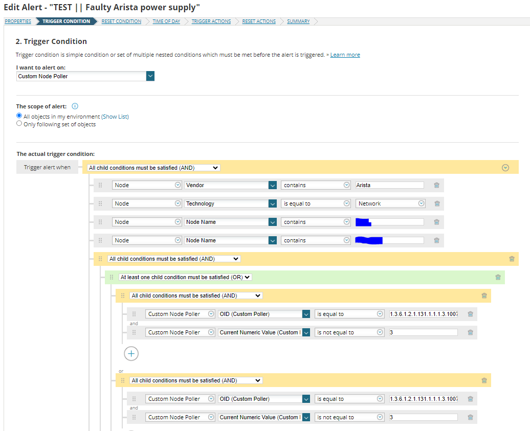

Opened a case with SW (01776807), only way was via UDP, which has been implement but we can't use the Hardware Health feature and implementing alerting via UDP is a nightmare (managed partially to implement alerting for PS1 and PS2 only)
