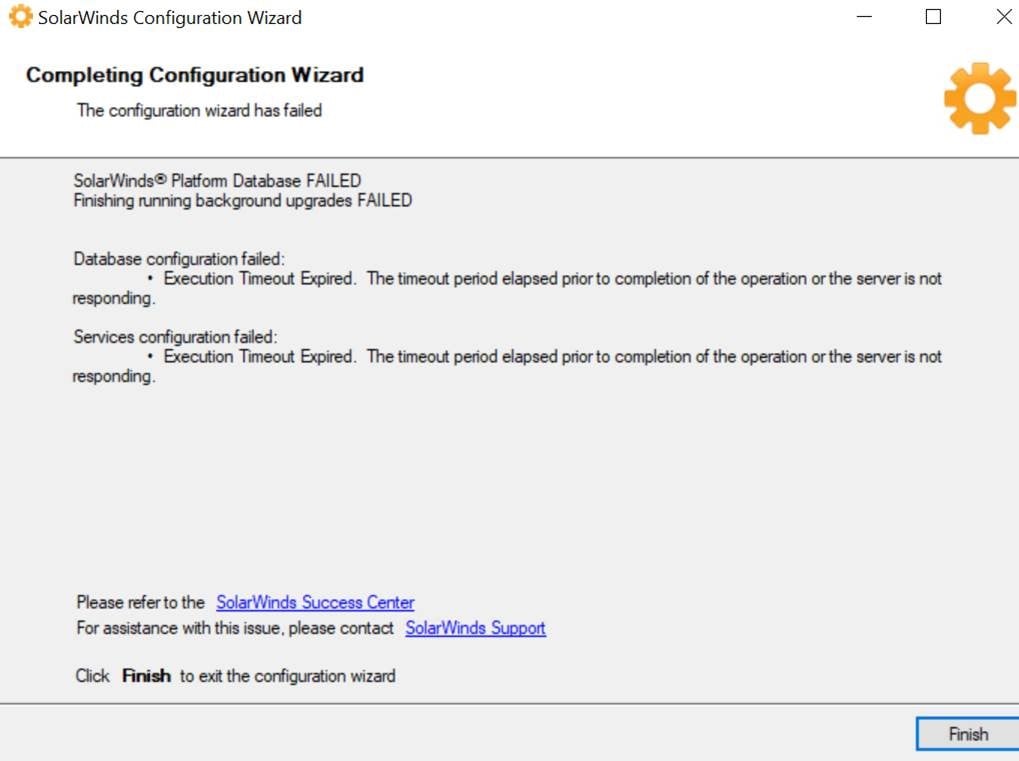

Is there any i can fix this? An entire poller is down. We are unable to pinpoint the issue and support has given up on this.

When got the error , We reinstalled the Solarwinds software on the Poller but we encountered the same error afterwardsThe next step gave us our first clue and was to use wireshark to look at the network traffic being exchanged. This showed us jumbo packets were being sent by the database but not received by the poller.We then ran traces on the SDWAN routers using the Cisco VManage application to further isolate the source of the issue. We found that fragmented packets with a MTU of 1419 were being retransmitted on the SDWAN router We also ran a trace in Cisco Thousand Eyes and it showed a very important detail of this issue. The traffic between the two sites is asymmetric, which also confirmed the issue with the MTU settingWe then looked at the MTU configured on the tunnel between SDWAN routers and found that it was the value was smaller than the size of our packet fragments.
The conclusion we drew from the data we were seeing was that when the connection between the SolarWinds poller and the database was initiated, the MSS value negotiated was too high due to the asymmetric nature of the routing between the two servers. This led to packets being fragmented at a larger size than what was allowed by the SDWAN router tunnel.
