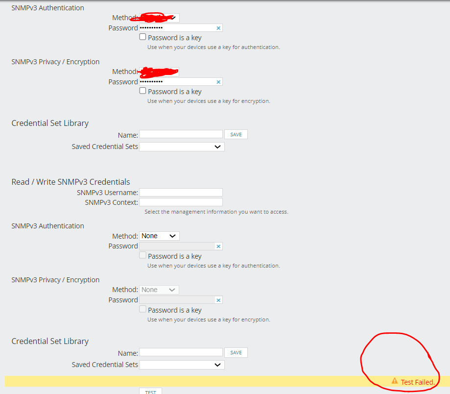

While reviewing our SW environment, I found that when testing the SNMP credentials for a few nodes, the tests failed.
However, the node status appeared as UP in the SW console, indicating that the SW detected their reachability using ICMP.
At the same time, other resources did not show the correct result for that specific node due to the SNMP credentials failure. Here's a snapshot for your reference.
Node Status Is:- UP
SNMP Credential Failed.
