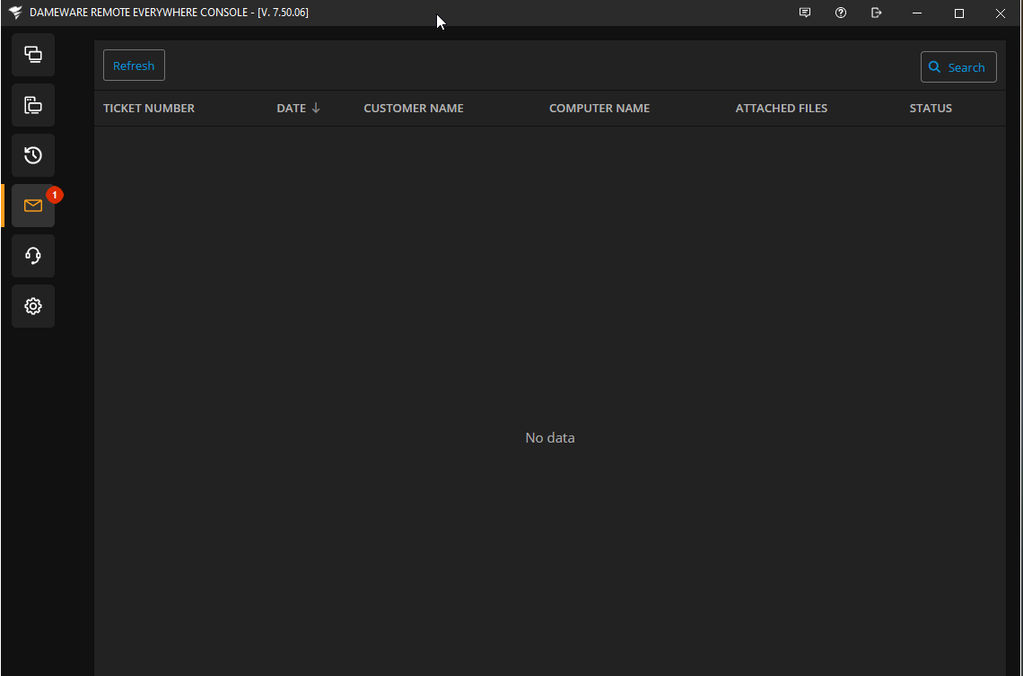

This is also weird,
Nothing there but the 1 never goes away.

I was able to download the other day and install fine, my issue is there are ghost notifications since install and continuing post update.
