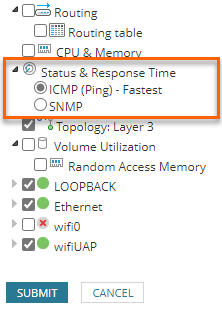

To the best of my knowledge, there are two ways to determine the status of a node. Via ICMP, the default, or you can change it to use the SNMP connectivity for status. This is done in "List Resources" for a node at the top where it says "Status & Response Time". ICMP is usually selected, but you can change it to SNMP.

This differentiation is shown in the "Edit Resources" for your particular device.
