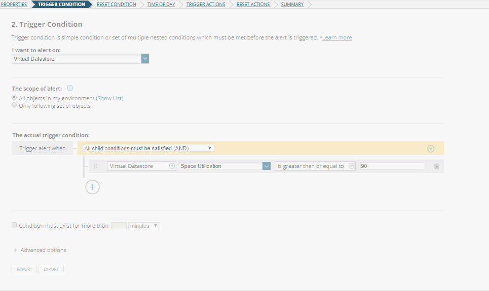

Will VMAN trigger a datastore low free space alert if the VMs attached to the datastore are allocated over 90% of datastore capacity using thick disk or is the alert triggered when actual stored data (OS, apps, files, etc) reach over 90%
krisj25 wrote:Will VMAN trigger a datastore low free space alert if the VMs attached to the datastore are allocated over 90% of datastore capacity using thick disk or is the alert triggered when actual stored data (OS, apps, files, etc) reach over 90%
krisj25 wrote:
This will be triggered based on the actual stored data. The alert definition simply looks at the space being utilized on the datastore and when it reaches 90% it will trigger.
@serena-- Can u confirm if the metric here is % or GB?
While selecting the variable in trigger action, there is no mention of % so...
wrote:@serena-- Can u confirm if the metric here is % or GB?While selecting the variable in trigger action, there is no mention of % so...
wrote:
% utilization
Thanks Serena...
