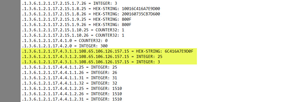

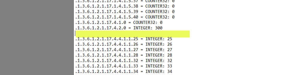

    From a working switch, (in this case, a C3850x) the relevant OID is .1.3.6.1.2.1.17.4.3
    I took your advice and did an SNMPWalk on one of my C9300 devices, looks like those MIBs have been completely wiped out of existence!
