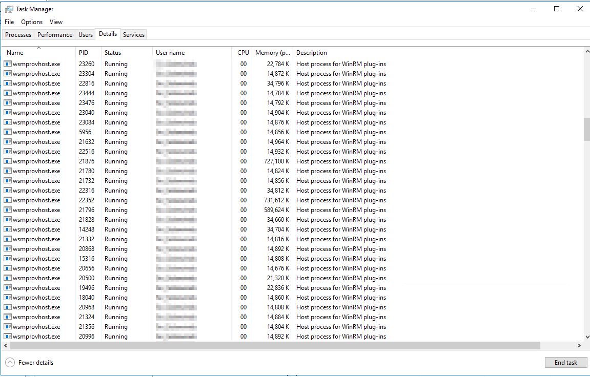

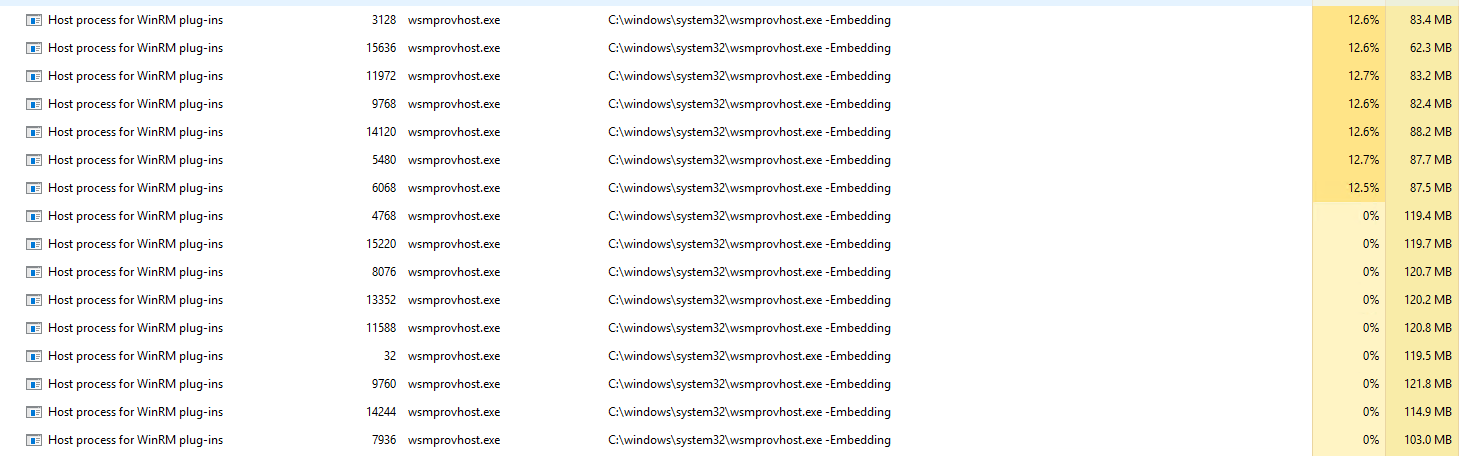

    Server was completely locked this morning and I had probably 100's of wsmprovhost.exe on the node and they were all tied to the Solarwinds Service account on the server.  I removed the monitor and will be rebooting the server.  Any ideas of what direction I need to look to and figure out what is going on?

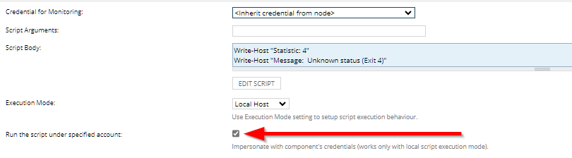

  • Can you paste a screenshot of the script component config?
    Is it set to remote execution or local?
  • Set as Remote Host.  Local host does not generate the correct data.
    I think this is what you were looking for. I am very green when it comes to PowerShell and Solarwinds.

  • We've kind of burned through the things that came to me top of mine when troubleshooting script executions.  From the screenshot you it makes me think that you are actually getting connected because all the processes are spinning up, are there maybe a lot of files in those directories and Orion is timing out the connection before it gets a response.  You might try remoting into the server and trying to run a version of the script locally to understand how it behaves.  Then I'd probably take it a step back and try to psremote over from the polling engine to the other server and see if anything noteworthy happens.  You might also consider taking a fishing trip through the logs, but i find that sam component logs are a real monster to dig through in many cases
  • Got the impersonation and remote/local settings the same?
