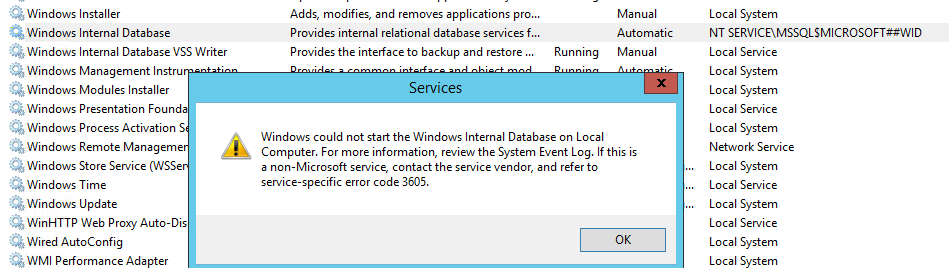

When I try and manually start the service I get below error:
“Windows could not start the windows internal database on local computer…..error code 3605”

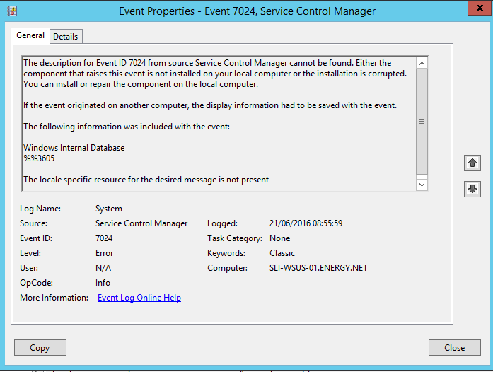

In event viewer:
The description for Event ID 7024 from source Service Control Manager cannot be found. Either the component that raises this event is not installed on your local computer or the installation is corrupted. You can install or repair the component on the local computer.
If the event originated on another computer, the display information had to be saved with the event.
The following information was included with the event:
Windows Internal Database
%%3605
The locale specific resource for the desired message is not present
