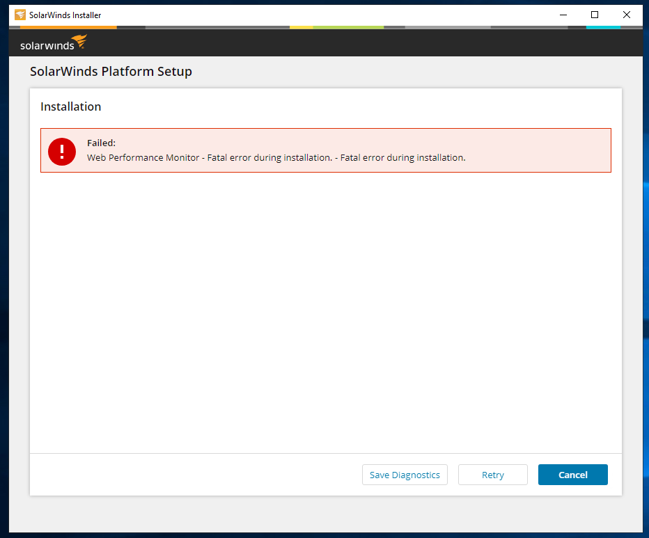

  • Tried the install via the My Deployments - Updates Wizard. Got to 95% and things slowed down progress bar got to 97% after 15mins and then the installation failed with the error...
    "Database configuration failed: Error while executing script- Cannot insert the value NULL into column 'Id', table 'NetPerfMon.dbo.CLM_CloudJobSettings'; column does not allow nulls. INSERT fails. The statement has been terminated."
    I was upgrading from 2022.4.0

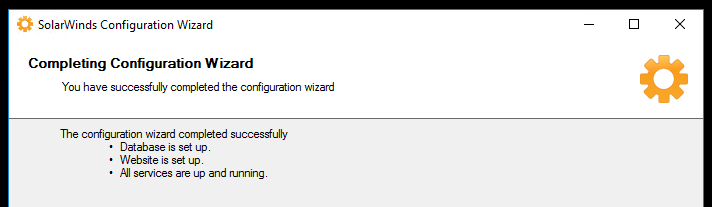

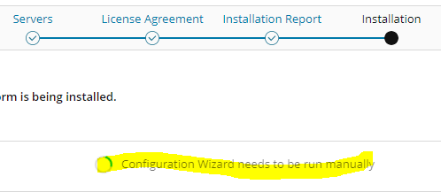

  • Found the SQL commands failing in the ConfigurationWizard.Log file and ran them manually in SQL Management Studio. They worked fine so not sure why they failed during the above install. Deleted the CLM_CloudJobSettings table and ran the Configuration Wizard manually. This time the database configuration completed fine. The Configuration Wizard went on to finish fine on my primary polling engine.
