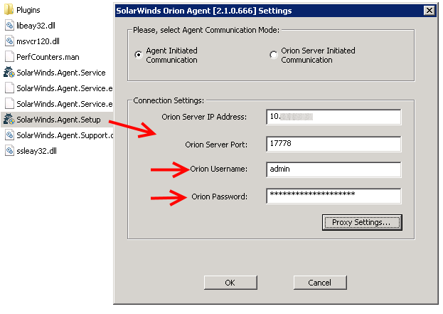

I install manually some agents (in the futur, it will be deployed via Symantec Altiris) on different virtual machines, but we always have the same problem :
Agent installation :
manually

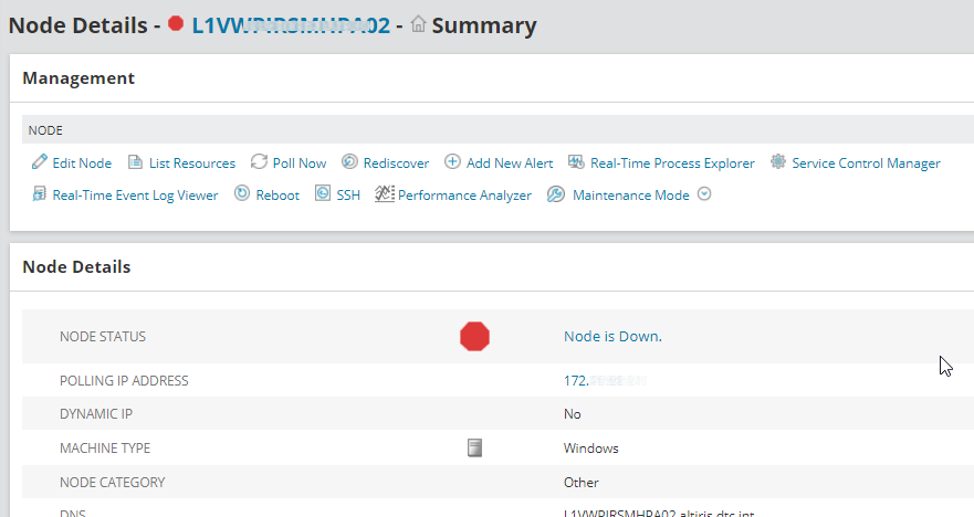

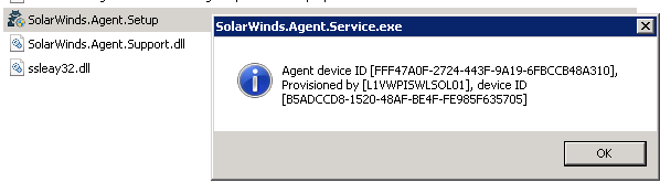

Agent appear in this strange status:
the node is automatically created, but state is DOWN
On the node, i try to list ressources :
and also tried via MSI/MST file on another VM and another Remote Poller

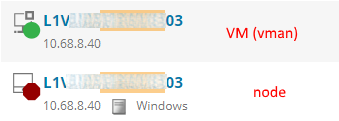

I need to go on the agent configuration, and SET AGAIN the user / password
ONLY THEN, the agent status become green, the AGENT/Node name change to the name of the VM, and Node status is green
I don't know, looks like the agent register after installation, but need a second registration to run properly? or maybe the user/password is not correctly send to my different Remote Pollers ?
