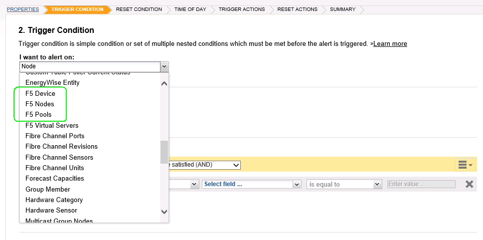

Has this been released?
Yes, you should be able to create this kind of alerts in the latest NPM 11.5 RC.
Using this built in method is there any way to alert on a particular member of the pool? I don't see any events for 'member going offline' nor in the fields that would accomplish this.

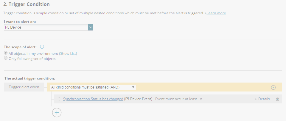

Hi All,
I know its old thread but I want to know how to create an alert when 2 LTM devices are not synched up or time sync alert for LTM devices (when time sync is more than =>3 minutes alert should be triggered).
There is a out of the box alert in 12.1 that will alert when the H/A status changes.
You could set the alert to wait 3 minutes before sending an alert.
