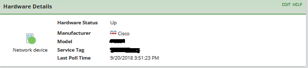

Thank you this was very helpful. Just in case someone would like more information on how this is done I added it below.Used this guide to find PollChecker tool and figure how to use ithttps://support.solarwinds.com/Success_Center/Network_Performance_Monitor_(NPM)/Use_the_Poller_Checker_tool
Steps to change memory to CiscoGen3 using PollCheck tool
Thanks for detailed information, It work for me for ISR 4331 as well as ISR 4351 ..
