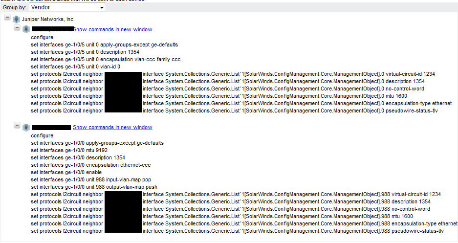

I am working on a new CCT and I'm running into an error that shows up in the output preview:
The part in the above picture that shows "System.Collections.Generic.List..." is supposed to output the user's chosen interface on each respective device. I am defining a 'string' at the top of the script because I need to append data to the interface name. Is there a problem with where I am defining this, or how I'm defining it? I guess the question is, how can I reference a 'foreach' loop from within a defined string? Script follows.
