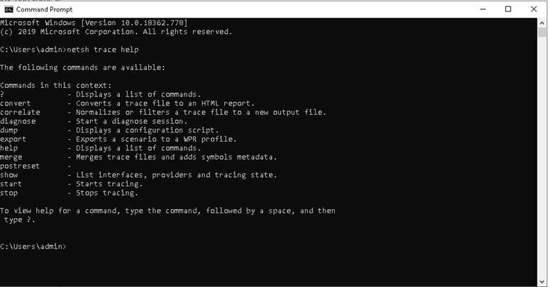

Netsh is a command-line scripting utility that allows you to, either locally or remotely, display or modify the network configuration of a currently running computer. Used without parameters, netsh opens the Netsh.exe command prompt and is capable of obtaining the network trace using the trace command.
Netsh basically exist on Windows 7, server 2008 and above machines.

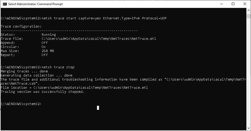

For Example:
Netsh trace start Capture =yes Ethernet.Type=IPv4 Protocol=UDP //captures all IPv4 UDP traffic.
To stop the trace, issue the command netsh trace stop

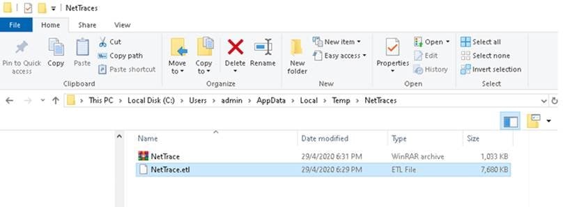

Location of ETL file by default at C:\Users\{USERaccount}\AppData\Local\Temp\NetTraces

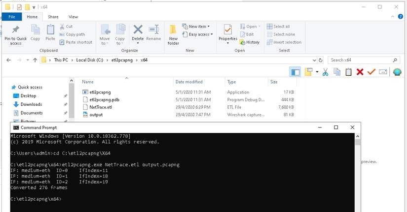

Convert to PCAP using PowerShell using ETLPCAPNG
Etlpcapng is a converter utility for ETL to PCAP on github
The executable could be obtained here
After extracting the files, place the file in the same executable as the etl2pcapng folder
Command: etl2pcapng.exe NetTrace.etl output.pcapng

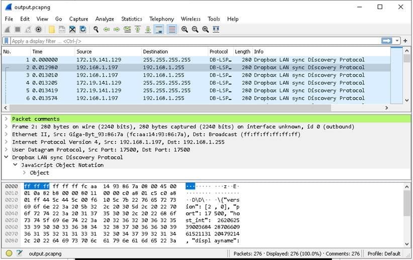

End Result: 276 packets captured and displayed
Once you have the ETL file and converted it to pcap, send the result over to support or you can inspect it yourself.
