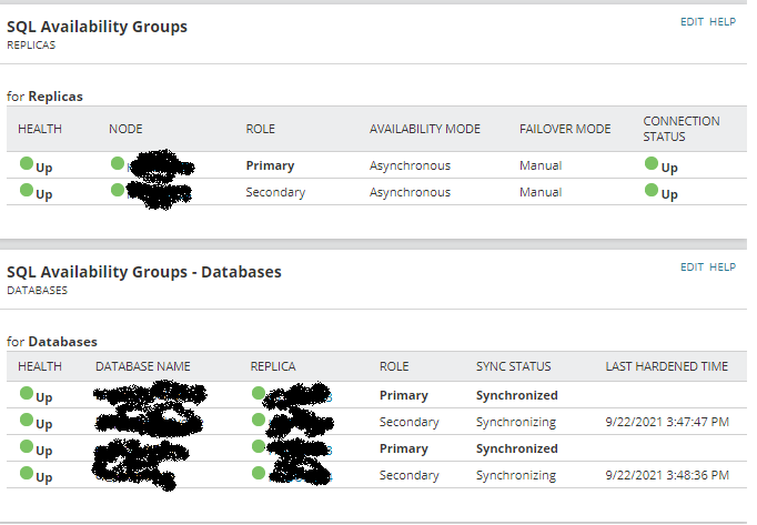

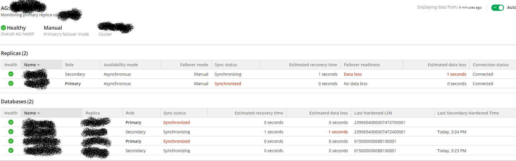

I have been asked if it would be possible to display information about Availability Groups from DPA on a dashboard in Orion.
With the help of @kpmarcin we were able to reproduce the following information from DPA
as Custom Tables in Orion with the following result:
However we had to use some workarounds as there is no documentations regarding statuses
Sample query:

So my question is if its possible to get our hands on any kind of documentation regarding the status codes for DPA or maybe there is an easier way to do it
