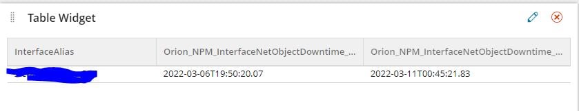

Just getting into solarwinds Orion and trying to build a custom Table Widget for a series of particular switch interfaces using the graphical builder.
What i am trying to list is the date and time the interface went Up and then Down and the total time it was connected for each instance.
I have been able to add one of the interfaces i want to display using the InterfaceAlias Option in the graphical builder and use the filter to show the particular interface i am interested in.

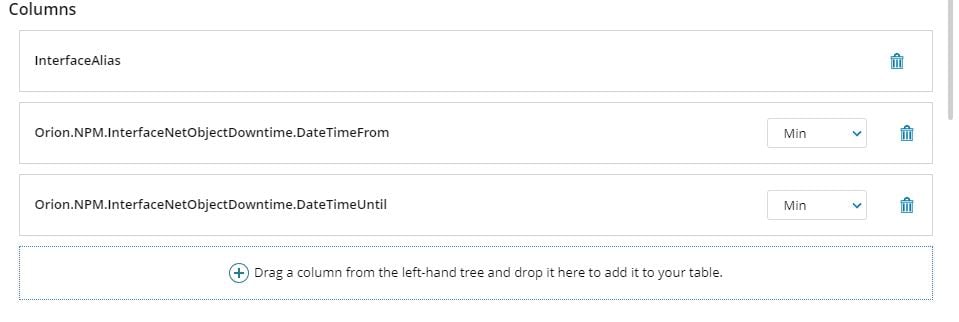

Problem was, i cant find any option for interface uptime, however found several for interface downtime such as,
Orion_NPM_InterfaceNetObjectDowntime_DateTimeFrom
Orion_NPM_InterfaceNetObjectDowntime_DateTimeUntil
Is there a way to do interface uptime within the graphical builder that i am missing?
As a test for the data i went along with the downtime option however it only provides 1 line of data instead of reporting the date and time of each occurrence per row so that if there was 5 occurrences that the interface connected that week it would show 5 lines with the start and end time of the port being online and the total time it was connected per occurrence?
Is there a way to achieve this ?
