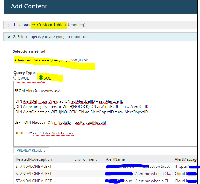

Here is a script to get you going ...
SELECT CASE WHEN ao.RelatedNodeId IS NULL THEN 'STANDALONE ALERT' ELSE ao.RelatedNodeCaption END AS 'RelatedNodeCaption', n.Environment, --this is custom property ad.AlertNameFROM AlertStatusView asvJOIN AlertDefinitionsView ad ON ad.AlertDefID = asv.AlertDefIDJOIN AlertObjects ao ON ao.AlertObjectID = asv.AlertObjectIDLEFT JOIN Nodes n ON n.NodeID = ao.RelatedNodeIdORDER BY ao.RelatedNodeCaption

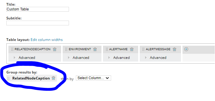

Couple things to note:

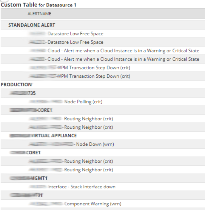

This is how it looks (here I have grouped by Environment and then by Caption)

ok, I just had a quick check and it may not be possible with report builder. You may need to use SQL/SWQL query instead. Are you comfortable with script? I can give you a SQL script example that will do the job, but you would need to expand it further to include all the rest stuff and custom properties that you need
Lets just say I am not uncomfortable with it. I will gladly take whatever you can offer. I will try to figure it out. THANKS!!!
