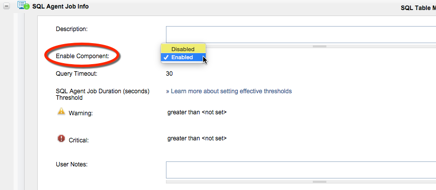

If you have no ability to disable the SQL Agent Jobs that are failing in your environment, then I would recommend disabling the "SQL Agent Job Info" component.
