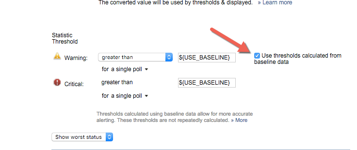

    Yes, though it is recommended that if you have a contextual understanding of the metric you are monitoring that you define these thresholds yourself manually. E.G. Percent Disk Space usage can probably be defined on your own without much assistance from the baseline calculator. You can also configure the template to use baseline thresholds, which after seven days of collection will automatically calculate and apply thresholds (where possible) to the component without any manual effort.

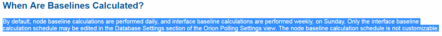

  • alterego,
    Is my interpretation of the following incorrect? It seems to suggest that node baselines are calculated automatically, but that the schedule cannot be changed like it can for interfaces:
  • What you are referencing above is for node baselines, which function differently than application baselines.
