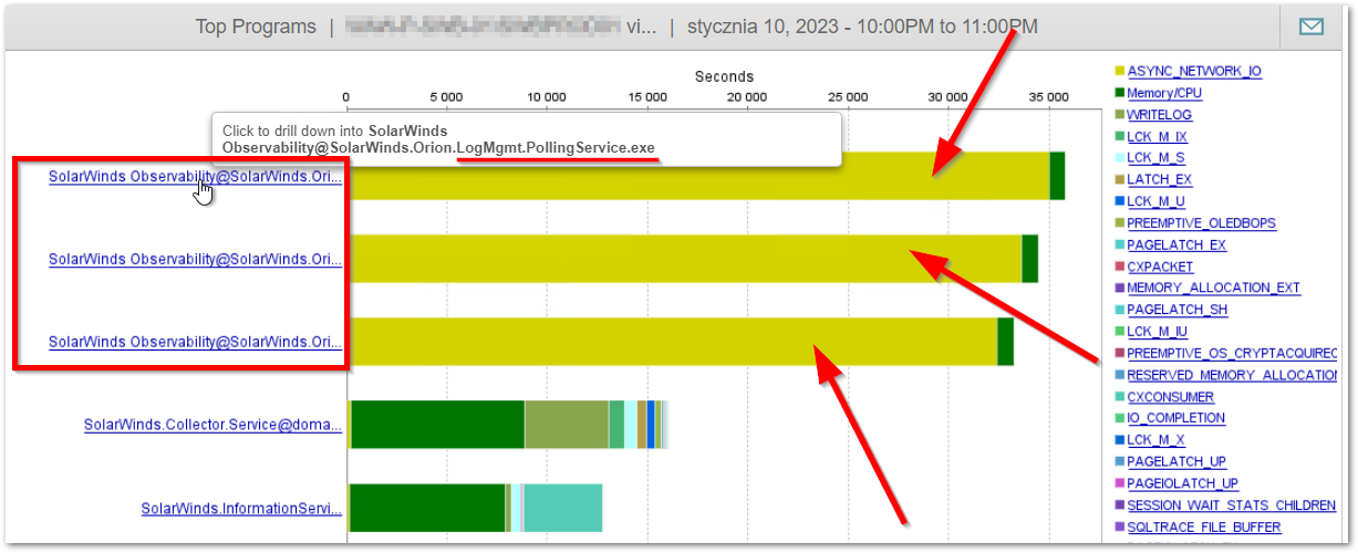

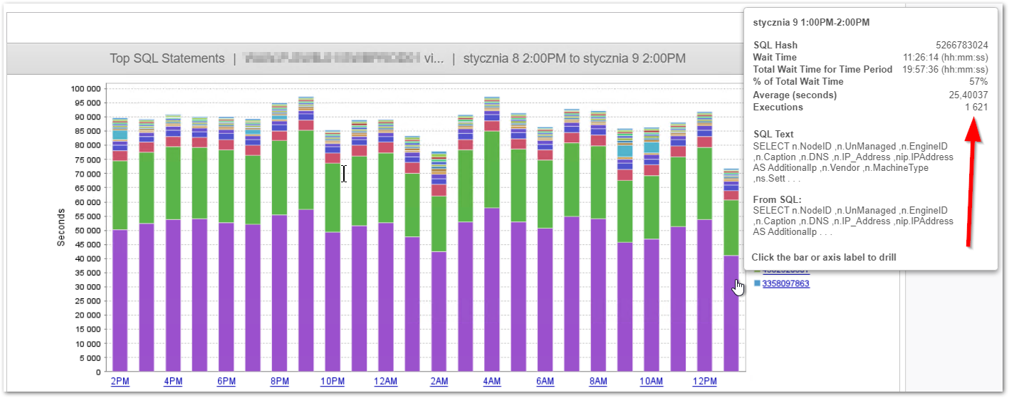

Our first DPA results were very surprising. We have noticed that there were two SQL queries (green and purple), which are consuming most or our CPU wait time.
You can see how many times those queries were executed, around 1.600 times per hour.
We have checked deeper and found out that Log Management service (Log Viewer/Log Analyzer) service was executing them.
This was strange, as we did not send that many Syslog/Trap messages to our Orion installation. So why Log Viewer is consuming so much CPU wait time?

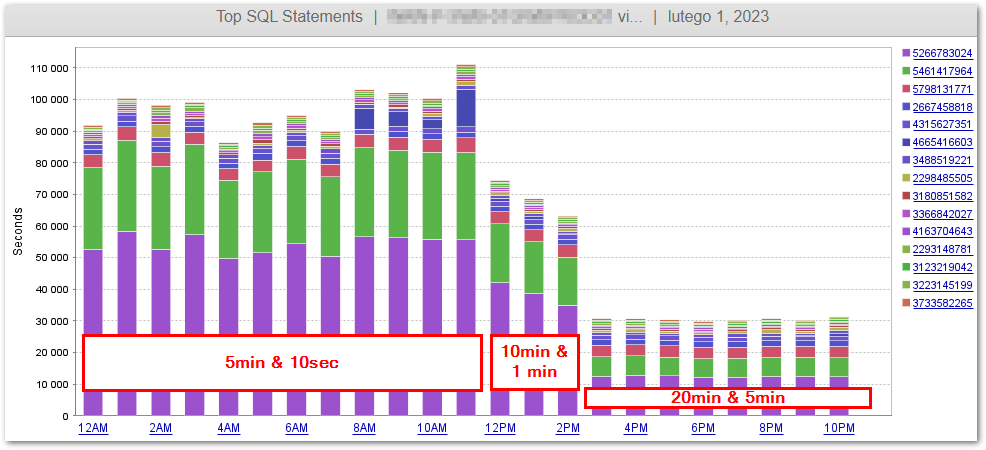

We needed to modify “Node Cache Refresh Interval” and “Node Cache Refresh cool down” in the Advanced Configuration. The change requires a restart of Log Viewer/Log Analyzer service (which Adv Config page can do for you)
By default, those values are 10 seconds and 5 minutes. Please check below DPA results and value changes for 1min&10min as well as 5min&20min.
The difference in CPU wait time is huge and we really noticed a better SQL performance.
After some testing, we decided to use 10 minutes for NodeCacheCooldownPeriod and 30 minutes for NodeCacheRefreshInterval.
