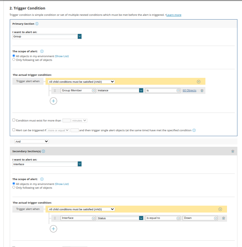

We have our devices in specific groups (IE Transport, Access, etc). We want to build an alert that factors in two criteria.
- Interface Down on a devices AND that the node is in the "Ciena" group
I've built this as a "Complex Condition" but it doesn't trigger when we put an interface down (screenshot below).
Do we have to specifically put the interfaces in the group or can we match based on the node being in the group?
Is there another way this should be setup? It seems like just a simple alert but nothing that I've tried seems to be working correct.
