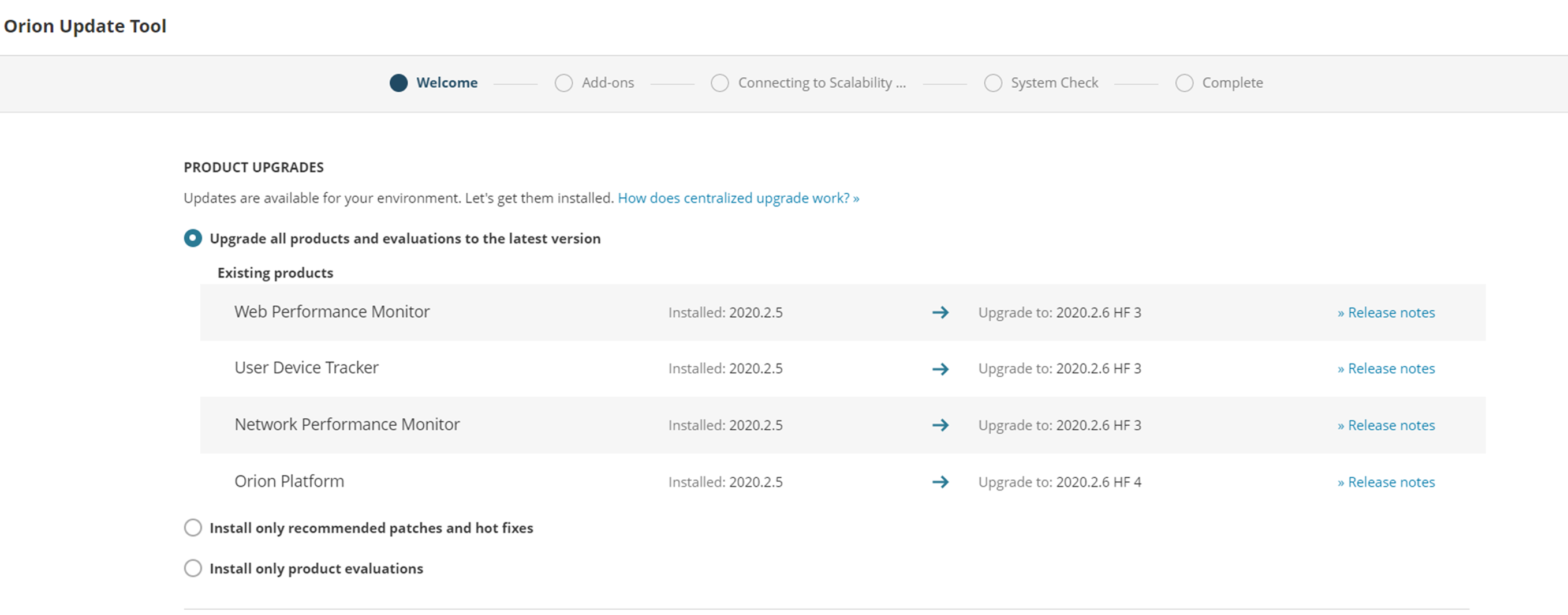

I'm confused about the pre-stage feature (currently on 2020.2.5)
I've run the offline installer which copied over files to my main polling engine and then the offline installer provided a link to My Orion Deployment which offered up a pre-stage button. I clicked that button which brought me to the screen below. I see nothing with respect to pre-stage and I am interpreting the below to mean that it would actually perform the upgrade (instead of pre-staging files).  Please help.  I'd really like to pre-stage all of my additional polling engines. I did put in a support ticket but they have stated that the pre-stage only copies files to the main polling engine not the APE's but the documentation i have read leads me to believe otherwise. Please help!

  • Ok. New information.  I WAS able to use the Pre-stage feature with the offline installer to upgrade from 2020.2.5 to 2020.2.6 HF4 (Orion) and HF3 for my modules - npm, wpm and udt.
    High level.
    Use the offline installer to pre-stage the main polling engine. Then you go to the My Orion Deployment on the web to perform the rest of the polling engines by selecting the Pre-Stage button. The gui looks confusing because it uses the same gui that you use to perform the ugprades - just ignore the upgrade labels and continue through. Eventually you will get to the list of your polling engines. I wouldn't recommend excluding any polling engines (if you are thinking of testing one and then coming back). It's really designed to splash the install files across all your polling engines in one shot. If you do only select one or 2 and exclude others you will need to cancel the pre-stage and start over - no big deal but you will have to re-do the pre-stage to the same servers you had done as well as those you excluded. Again not a biggie but sharing.
