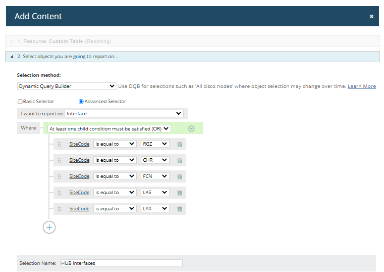

Essentially, I have a node custom Property that I want to use to filter the Utilization report.
I tried to edit the Out of the box one and edit the Dynamic Query Builder.  But I could not seem to get all the needed results.
I would also like to mentioned that this is Node Custom Property and not Interface Custom Property.  Interface Custom Property works fine.

    If you want to get the node custom properties when you are filtering on interfaces you can do the following:
    First, select Interface in the Dynamic Query Builder and make sure 'Advanced Selector' is on.
    Then press 'Select field' and in the new window, use the drop down to change from 'Interface' to 'Node':
    After this, you should be able to select the Nodes Custom Properties through this:
    You can do the same when adding in a column in the table too and you'll see it listed as a Node Custom Property:

  • I actually did that, but it does not show all the interfaces for nodes with that Node Custom Property.
